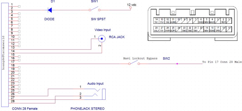

    Quick schematic for anyone want to DIY
    Note that mod at pin 17 allows you to interact with the navi and phone systems as if you were parked. The GPS will not update your location on the map when speed sense wire disconnected. Once the switch is connected, may take ~ 15 seconds for GPS to update your location.

    Nice drawing. As for the GPS not finding location, I have had no issue with it. Even with it in override, the GPS keeps up. Obviously YMMV.
    Thanks for this.

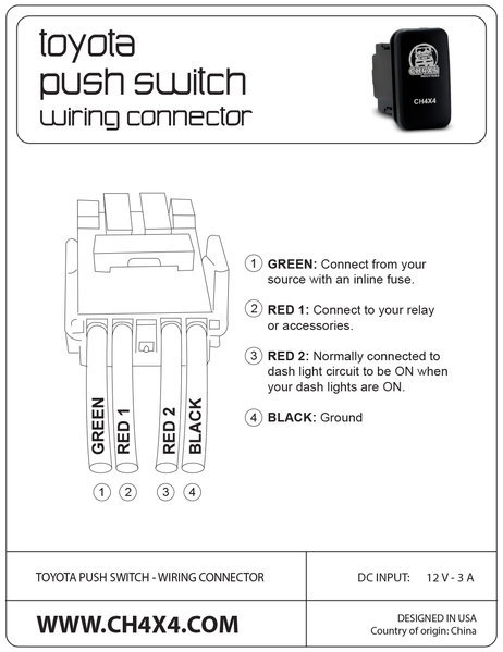

    Can I use a push button type switch for the nav bypass?

    Yes, provided it is an On/Off SPST switch.
    @Hoangde - might want to tweak that diagram to better illustrate that the diode / switch are add-ons to the wire coming out of pin 2.
    Also, the pin locations are from the perspective of looking at the back of the radio, not at the face of the plug that goes into it. Not entirely sure what'd happen if someone got it backwards, but it probably wouldn't be good.

    I am trying to use this switch.
    Will this work and what wires would I connect the 2 cut ends of the speed sensing wire?

    From the description/diagram it looks like you'd use the Green and Red1 wires. Double check them with a continuity tester. I haven't yet used that sort of switch.

    2020 T4R TRD PRO
    green wire -> +12V power
    red #1 wire -> reverse
