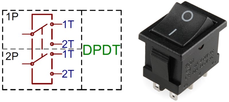

    Yes you can. If you have this switch :

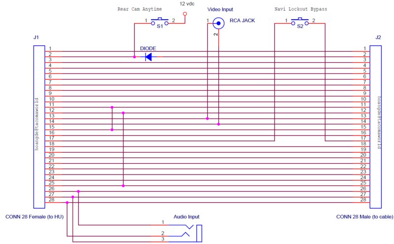

    if you leave wire 2 on the J2 side disconnected, wouldn't that disable the rear camera when in reverse?
  4. Jan 17, 2017 at 8:55 AM
    #104
    gpb
    gpb Well-Known Member
    Aug 24, 2016
    #195408
    6,451
    Atlanta
    2017 White DCSB TRDOR 4x4
    Yes, as shown you'd lose the camera turning on when you shift into reverse and the diode serves no purpose.
    The wire from J2 needs to remain attached to J1 (the side going into the radio). The diode needs to be on that wire to prevent voltage from backflowing to J2 pin 2 when the switch is engaged. S1 would be an SPST switch, ideally wired "normally open" if

  5. Jan 17, 2017 at 9:17 AM
    #105
    gpb
    Aug 24, 2016
    #195408
    6,451
    Atlanta
    That looks good for the reverse-cam mod. :thumbsup:

    are the J2 side of the video and audio input wires to be abandoned?
  7. Jan 17, 2017 at 9:28 AM
    #107
    gpb
    Aug 24, 2016
    #195408
    6,451
    Atlanta
    I don't know. I've not researched whether those are the primary inputs or an additional/secondary set of inputs.
    Unless you're intending to do something with audio/video I'd just leave the wires in place.
  8. Jan 17, 2017 at 10:19 AM
    #108
    Hoangde
    Hoangde Well-Known Member
    Sep 6, 2016
    #196593
    589
    Thanks guys,
    Updated
    Note:
    From fbconvert:
    "You have to select the display input on the OEM radio just like you would a Bluetooth device. If you jump the two pairs of pins like I show in the diagram the you will see a new source option appear next to the Bluetooth option that will say A/V. If you connected your iPod like you said then it will display on the screen. You will also be able to control the volume via the radio knob just like you would a Bluetooth input. "

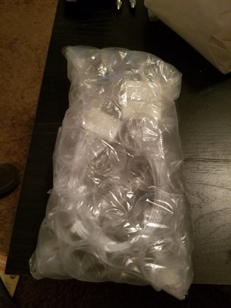

  9. Jan 17, 2017 at 11:15 AM
    #109
    Taco16LB
    Taco16LB Well-Known Member
    Sep 30, 2016
    #198602
    1,900
    I hope you still have these as I just paid you for one .
    PS As @gpb said , if this were posted in the 3gen section you would sell a lot to us . If it were not for @gpb I never would have seen it .
    jshsltr[QUOTED][OP] likes this.
  10. Jan 17, 2017 at 12:55 PM
    #110
    jshsltr
    jshsltr [OP] Well-Known Member
    Sep 3, 2012
    #86120
    1,056
    Josh
    St Louis
    I have plenty of these harness.
    As for the other questions, I will get back to them this evening when I get home from work.
    Thanks
    Taco16LB[QUOTED] likes this.
  11. Jan 17, 2017 at 1:23 PM
    #111
    gpb
    Aug 24, 2016
    #195408
    6,451
    Atlanta
    From the 2016 FSM, this connector is named N25 on the navigation head unit and the pins above are listed as follow:
    N25-15 is a Parking brake switch signal indicating when the parking brake is on or off.
    N25-11 is shield-ground
    N25-12 is not mentioned
    N25-25 is External Device Connection Signal and routes to the AUX/USB jack assembly in the center switch panel above the cup holders.
    Personally I'm not thinking that jumpering those two pairs would be wise on a third gen truck without further info.
    As for the A/V pins mentioned:
    N25-26, N25-27, and N25-28 also go to the same assembly and is the audio input.
    N25-13 & N25-14 are not mentioned.

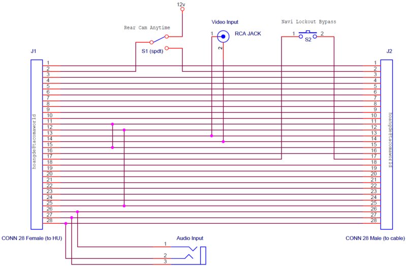

  12. Jan 17, 2017 at 1:41 PM
    #112
    Hoangde
    Sep 6, 2016
    #196593
    589
    No diode if SPDT switch is use for Rear Cam Anytime:
  13. Jan 17, 2017 at 1:49 PM
    #113
    Taco16LB
    Sep 30, 2016
    #198602
    1,900
    ? from a nonelectrical guy . Where do I get the 12V + from . Do I run a wire strait from the battery ? Does it need a fuse and what amp fuse ?
    For the rear view cam .
  14. Jan 17, 2017 at 2:13 PM
    #114
    Hoangde
    Sep 6, 2016
    #196593
    589
    Tap 12 vdc from Grey wire as indicated (not recommended).
    For my Taco, I'd connect directly from PowerOutlet fusebox.

    I think that is for the camera mod which is helpful. But I am looking to do the nav bypass mod which is interrupting the speed sensing wire. I am assuming one end to the green and the other end to red 1.
  19. Jan 17, 2017 at 3:22 PM
    #119
    opentang
    opentang you're doing a good job
    Apr 18, 2014
    #127961
    746
    Brandon
    2020 T4R TRD PRO
    That'd be my assumption too which would complete the circuit when enabled
