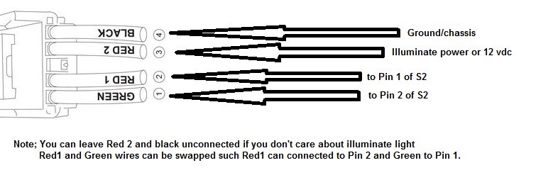

    I hope I am not too late... The Red#2 wire goes to +12v. This is for the switch illumination. Black is ground for illumination. Cut wire 17 in half. The Red#1 Green go to the ends of wire 17 that were cut. This is for NAV lockout override.

    Could you explain that one? The diagram descriptions for each wire would suggest Green & Red #1 comprise the SPST switch while Red#2 and Black comprise the illumination terminals?

    Red #2 and Ground are for illumination only

    Honestly, you would be better off using two switches. With the DPDT switch shown, you would have one of the following issues depending on how the switch was wired:
    1. Nav lockout override would ONLY be active when you have the reverse camera anytime active.
    2. Nav lockout override would ALWAYS be active when the reverse camera anytime was off.
    If you can live with one of these scenarios, feel free.

    This is exactly how it should be wired with the diode.
