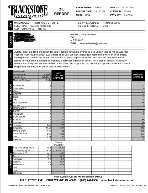

    First blackstone labs report came back. Everything seems to be good.
    I thought I had specified 5,000 miles of use but must not have, although they came in pretty close at a 5900 mile estimate.
    They sent me two more kits in the mail, I will try again in another 5k.

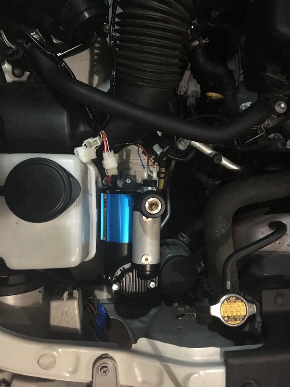

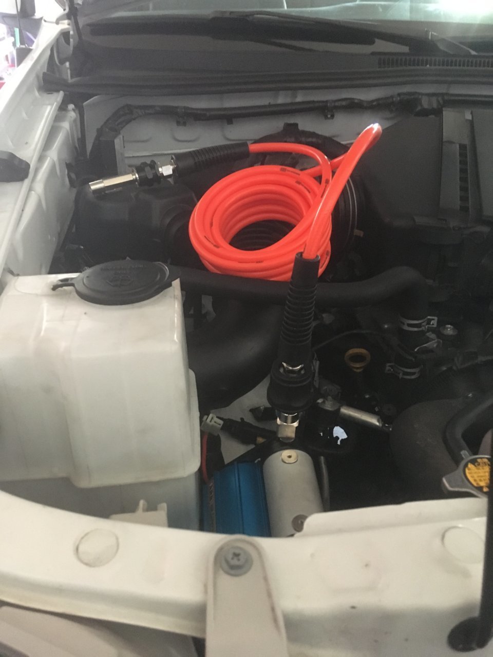

    Installed a single ARB air compressor tonight. Thanks to @ramonortiz55 for the group buy.
    I ordered the ARB pump up kit from Amazon and the Slee off-road mount (which is awesome).
    The install is fairly straightforward but I couldn’t find any good videos online to walk you through the wiring process. @boogie3478 this is low hanging fruit buddy. You are welcome to borrow my truck too if this isn’t a mod you’ll be doing in the immediate future.
