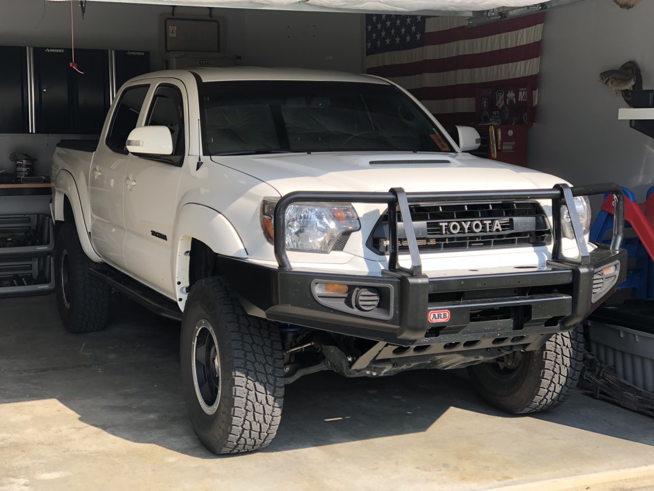

    Got the Dakar heavy duty leaf packs installed today. The ride is surprisingly smooth. I like it better than the AAL for sure. Took me about two hours to install the drivers side, due to the learning curve, an hour to do the passenger side. Well worth the money.
    Before measurement with progressive AAL & overload - 24.5”
    After: 25.25”
    Thanks to @assaultrecon28 for his install write up.

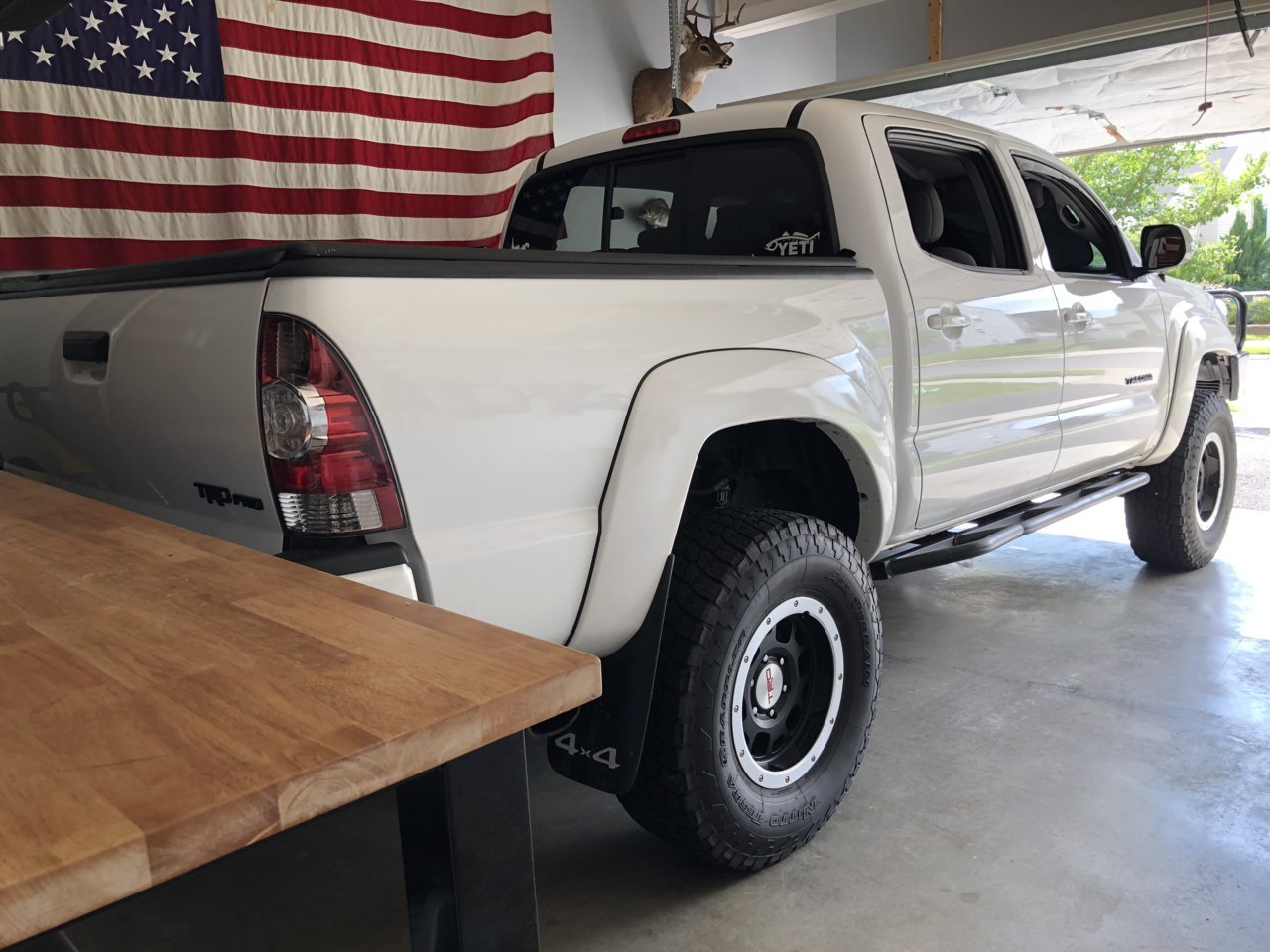

    Had a day off and all to myself - rare combination. Got around to doing a few maintenance items on the truck.
    Changed the front brakes. Added Hawk HPS pads and Brembo blank rotors. Greased the UCAs, put some tri-flow dry lube on the uniball and went over almost every nut and bolt on the truck to make sure it’s all torqued to spec.
    Since it’s not my daily driver, she’s nestled back in the garage with old glory. Good day. :thumbsup:
