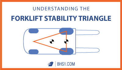

    I totally thought I was back in forklift class with some of this explanation. All I could think of was thisUnderstanding-the-Forklift-Stability-Triangle.jpg
    ovrlndkull[QUOTED] likes this.
