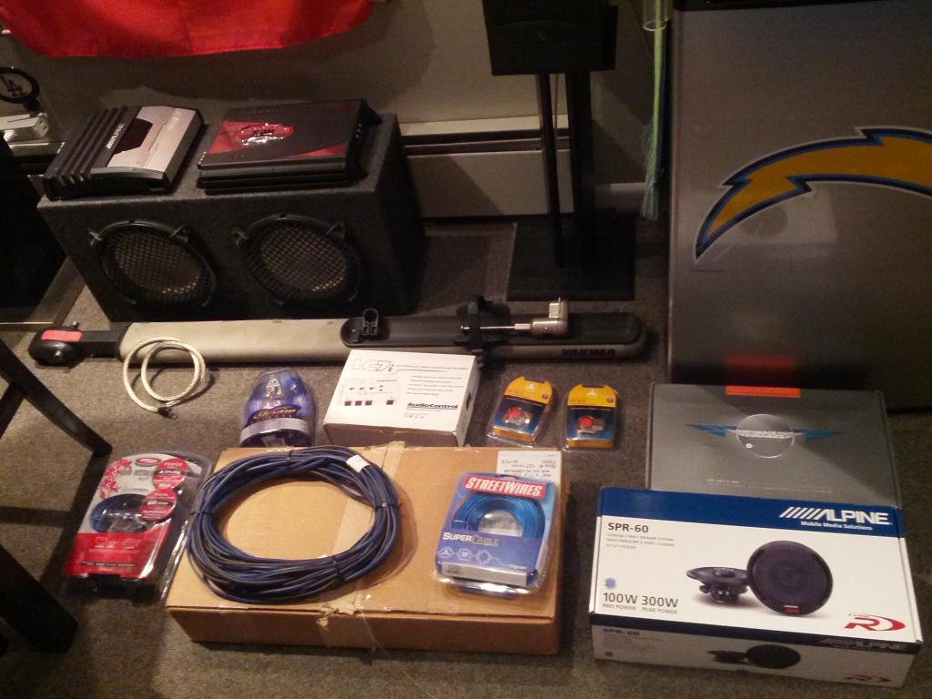

    haha, i was just googleing last night to try and figure this out. i was thinking i had to go the way of solder but i conculded that butt connectors properly crimped will suit my truck audio needs. have to put all this in:
