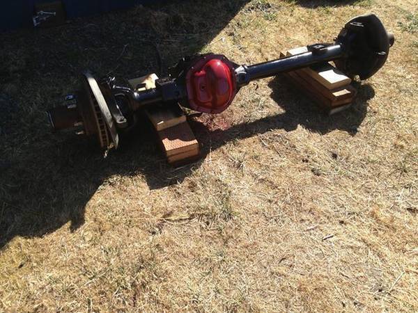

    So are you going for small? at 60.5 WMS to WMS your going to have a hard time tires in there.

    Well my wheels have 4.5 backspacing with a -13 offset - so they're pushed out pretty damn far. And i don't plan to stuff it by any means ;)
    and my rear is only 60 wms if im right
    By no means do i plan to keep it small ;)

    Oh and yes the axle is upside down :eek:

  7. Aug 5, 2013 at 9:50 AM

    lol ^^ This kid -
    nah i decided not to go with 53s...
    But i'm keeping my stock bumper and running 37s, so however high it needs to be, so im guessing frame height of 27-28. :notsure:

    LOL 4.5BS is nothing! I'm running 3.15" and my old wheels when i was IFS was -44mm off set. A 4.5" BS is mild to say the least.
    And try steering your rear wheels at a 60" wms even with 33's your going to be running into the frame when turning unless your truck is sky high then you will just run into the leafs assuming your doing leafs.

    Yeah that's going to be tough 37's on that skinny axle you wont have any steering even at 28" I wouldn't do more then 35's on that axle.

    Well i'm just guessing on what the frame height will be, after the coilovers are on it could be + or -, i can always test 37s and if they piss me off i can dismount and run 35s, i work at Les Schwabs so it'll be easy for me :)
    BTW JLee i will be linking the front end - not leafs.

    So your linking it and not stuffing it with a 28" frame height on 37's :confused: you can get way lower then that linked.

    I have no clue - i haven't gotten to that process yet, Once i finish the axle then i'll start the bracket design and buy the tubing.

    Yeah linked on 37's you should be closer to 24" or 25" hell if you don't care about up travel you could even get it down to 22" and be all droop!

    lol i guess i'll figure that out down the road. My only goal was to have full turn with 37s, that may mean bigger coilovers or spacers but just haven't taken that turn yet. Not that i have the axle .... ITS BEGUN!

    Yeah full lock with a 60" wide axle is going to be tough with 37s. I'm at 66.5" and I just about hit the frame and lower links at full lock stuffed.

    well sheet - - - i'll have to figure something out. That's where going higher may need to come into play
    your using a diamond axle right??

    Do you think i should replace any U-joints/ seals?
