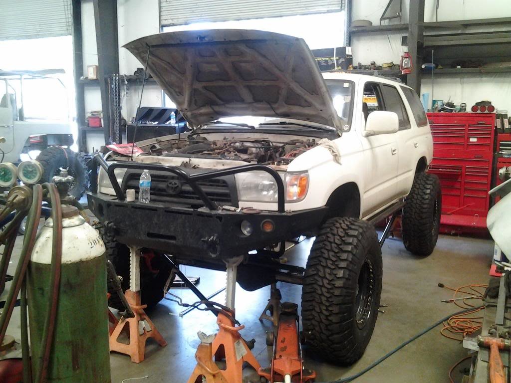

    1996 4runner SR5 4x4 - 419,000 miles, 14" Spacer Lift
    Links are all mocked up, everything measures out great!!
