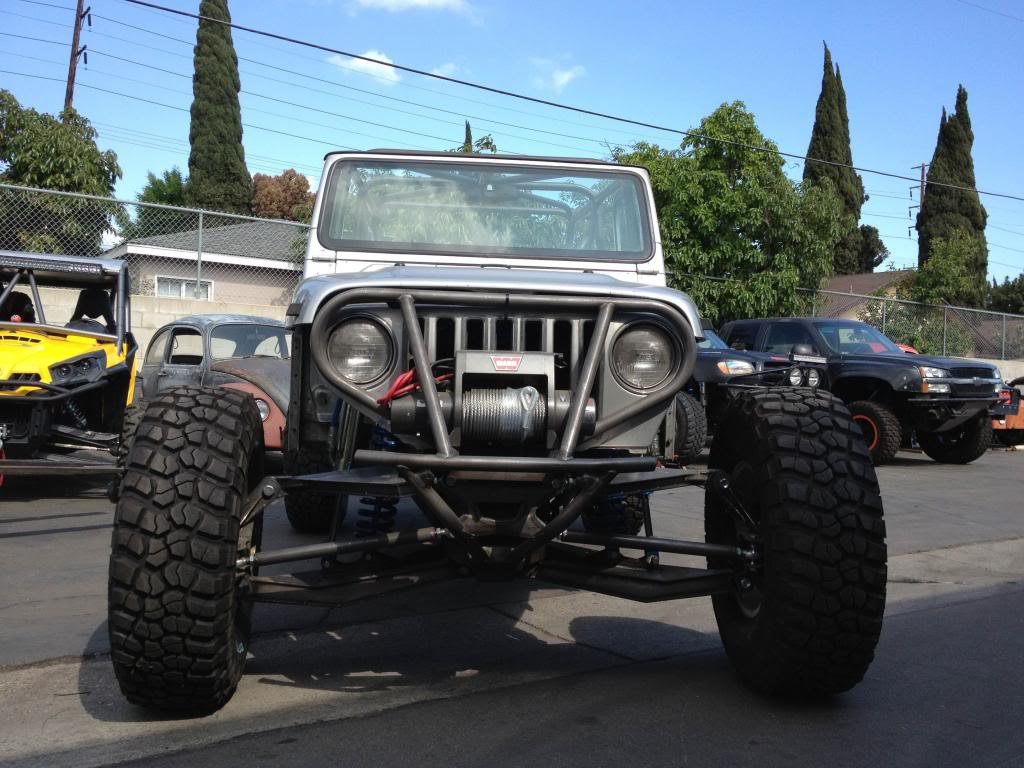

    Yeah that thing is sick! I was looking at it on TTORA earlier today

    he can build this, but aparanetly can't get a snorkel to fit properly.

    Hey! You're doing it wrong. IFS AND a Jeep?! :p

    Well that's a lot of unnecessary flex.

    Yeah you can see the coil popped out in the rear it's a lot of unusable flex as well :D Let me go disconnect my ORI's i can do the same thing :laugh:

    properly retained and with a centering cone, the coil will go right back in every time. all of the land rovers i wheel with do that. they sit jsut barely above stock height, but have a foot and a half of drop. limiting factor is joints binding.
    did the same thing with my offroad trailer, and never had a spring reseat wrong after losing contact with the collar.

    You actually built that and drive it on the street? :eek:

    all of the time. it's made multiple 1000+ mile single day trips, in addition to wheeling. i feel more comfortable pulling it than i ever did when it had leaf springs.
    edit: it has shocks now (not pictured), which really help it ride well.
