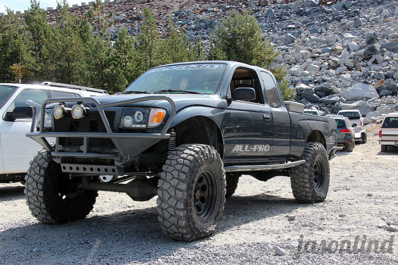

    saw this on fb today

    Isn't that Kurtis's rig? Pretty sure that thing had a flop bracket lift before the SAC. It's come along way. :D

    99% sure it's a full width D44 in the front of that Taco. Sorry to burst your bubble :D

    Do you know if this has a build thread??

    The easiest way to tell, for me at least, is the inner C shape. D44's are tall and skinny, D60 are short and fat.
    My old truck had a D44, don't beat yourself up :D Actually, the new owner swapped in a Dana 60 front and 14 bolt rear with 40" Iroks. He just finished up the Atlas install too :eek::eek:

    I don't know i think you can get more for your money. Sure it has a 3.4L swap but it's leaf sprung and on tiny Mini truck axles. i would want bigger axles and linked for that price tag.
