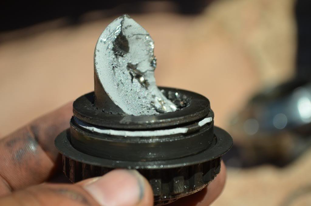

    If you do by way of Slodgetto, make sure you have many spare CVs and manual hubs :D just an FYI. He had my old CVs when he broke the CV and the hub at the same time on Z Turn on the Moab Rim Trail.

    Haha nice. Neither one of those are too bad to replace. On 37's though something's gotta give.. and I'd rather it be cv's and hubs than r&p and spiders

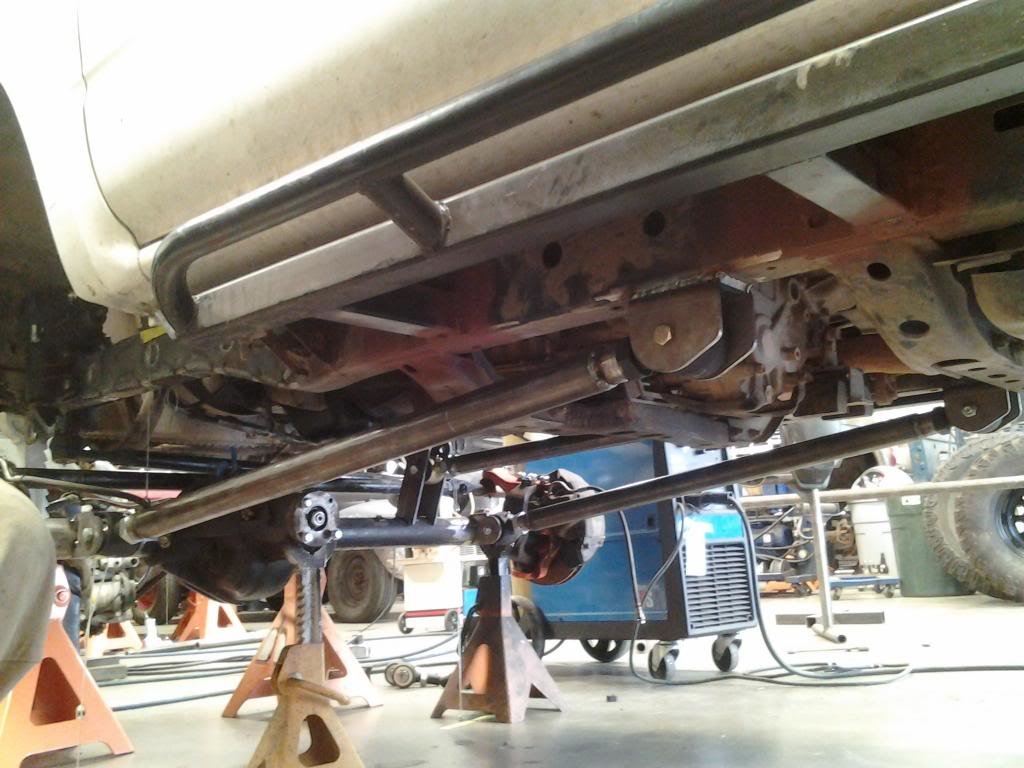

    Made some progress. All lowers are in and the front upper is in. Rear upper goes in Monday then we're onto the coilover towers...
    Don't mind the front upper in the pic... it wasn't done when I took the pic.
