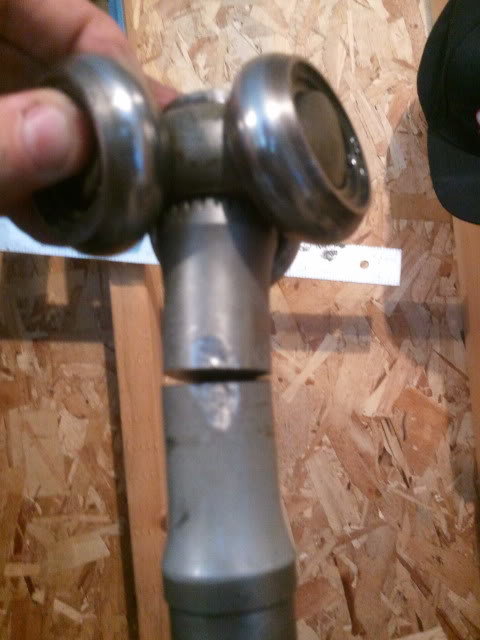

    Upgrade the stubs to 35 spline immediately. When a stub breaks due to a torsional failure (overloading) the shaft breaks at a 45° like this:
    So if you imagine it breaking then trying to spin on itself, it widens up. Well it cant do this running inside a spindle so it usually splits the spindle as well. They also usually break the locking hub )depending on what hubs you have).
    So now your $100 you save not upgrading that one stub is gonna cost you a locking hub and a new spindle, plus you now will buy the stub too.

    brings me back to the long nights in the materials testing lab :rolleyes:
    that's a beautiful break though. you should give that to an engineering school as a teaching aid. shows perfectly where the break started, and the two failure methods within the material.

    :spy: I googled torsional shaft failure to get a pic. I believe its a Porsche 930 cv axle.

    Here's my broken shafts...joint binding creating a stress riser and failure in bending. :D
