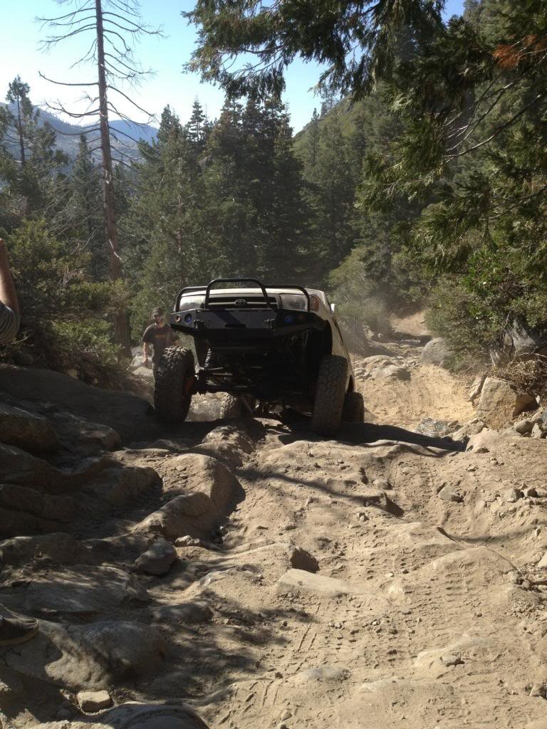

    LS Swap 500 hp......
    on da taco max of the fj80

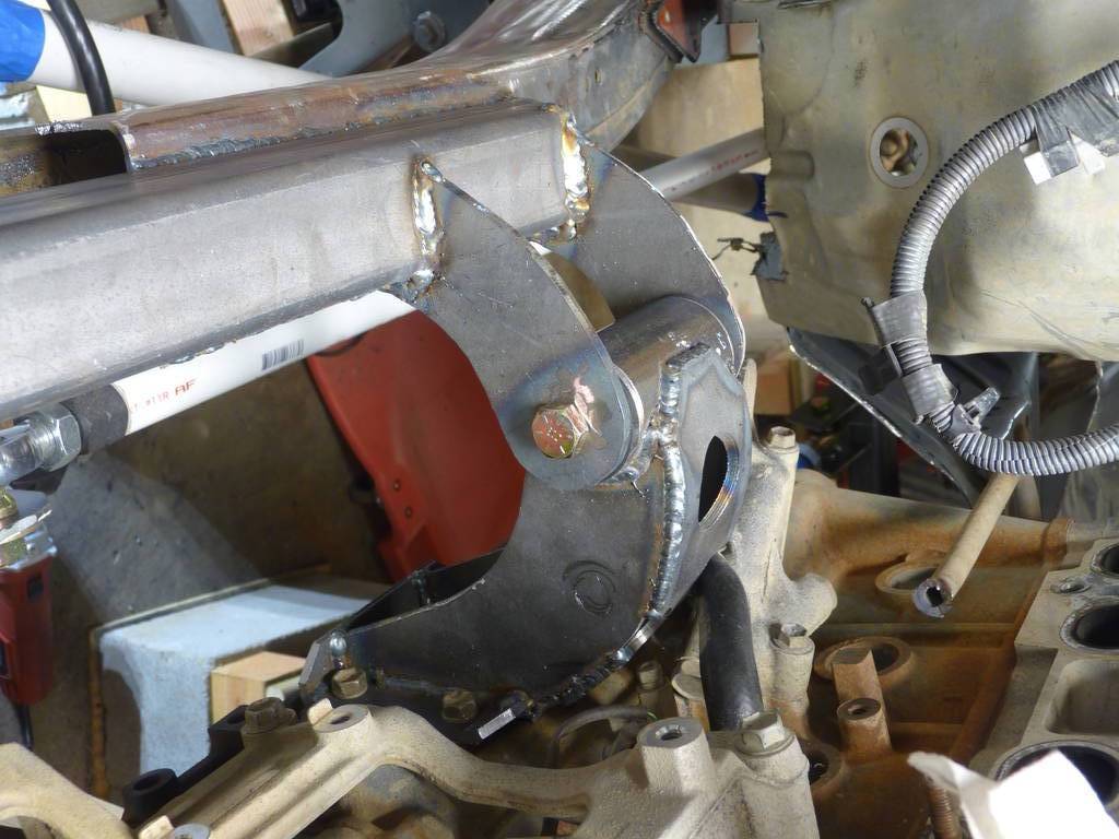

    I'm planning on welding some 1/4" to the bottom of the bracket to keep the joint off the rocks.
    I know it's completely retarded to be asking now since I already did it :rolleyes:, but is there any reason I shouldn't run the motor mounts like so?
    It's unfinished, more plate will be added. I have it arching as much as it is to clear the upper link. Drivers side looks similar.

    Mount should be A-OK like that!

    Some bracing would help that motor mount for sure.

    He's talking about the shape, its not finished yet.
    And about the links Jon, I was referring to keeping the links themselves higher by rotating the lower mounts, not necessarily the joints. The higher the links are the less you are gonna be sliding on them, and the less potential for bending them, etc.
    Think of it as having your sliders an inch higher than they are now, you would use them less, only your sliders are crucial to your vehicles performance..

    Fuck. I know you're right, these damn things were just such a PITA to make though haha :anonymous: I'll start again, and hopefully they'll be a little cleaner this time. Do it right or not at all.
