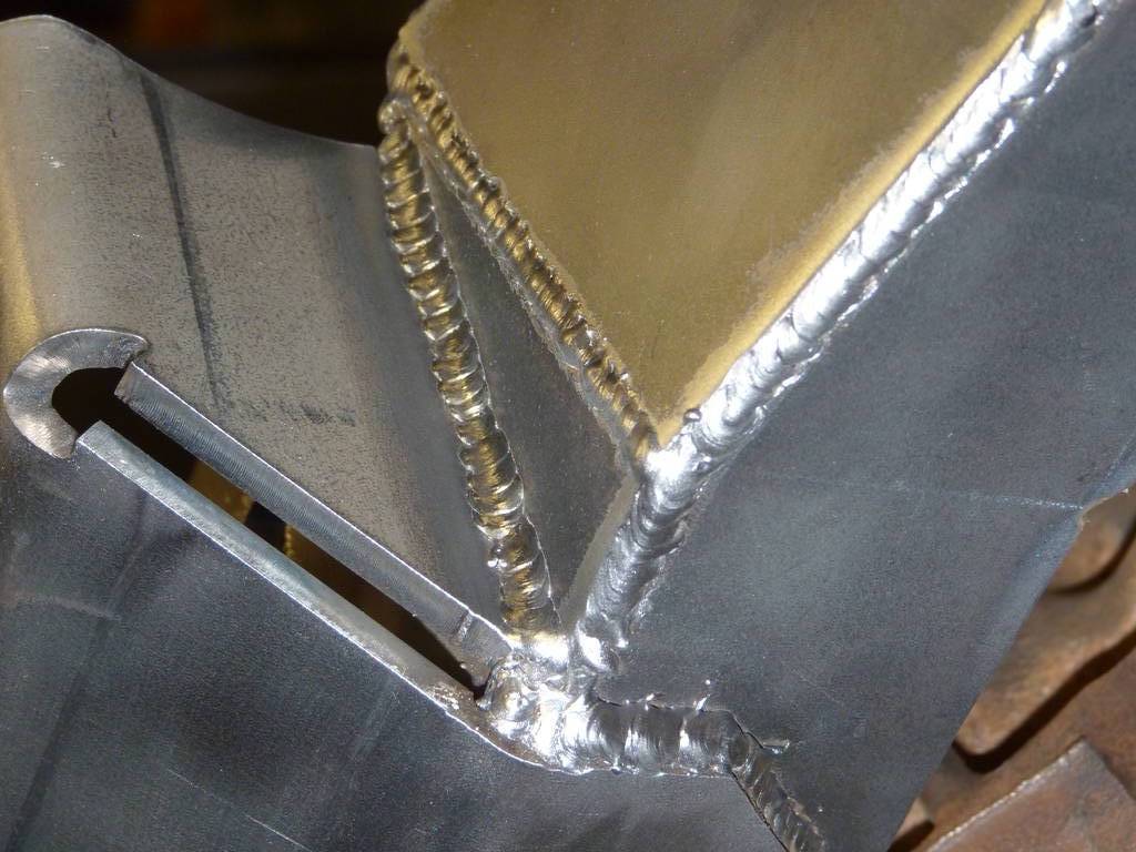

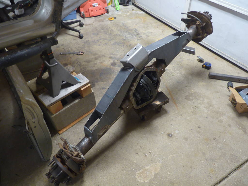

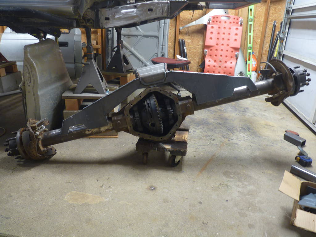

    Finished the truss. Welded inside and out, boxed, all 3/16" plus the 1/4" Ruffstuff 4-link bracket. Open area was to accommodate shock mounting, I was leaving it blank for now until I order up the ORIs.

    looks good any shots of the welds?

    Thanks. Yeah, my welding quality is steadily improving.

    But what's the purpose of doing this? i saw that JLee also did this to his rear axle, makes it look massive and bionic and ass weight...so whats the deal?
    Found this: Kinda explains it
    http://www.artecindustries.com/Dana-44-Wagoneer-MODULAR-Rear-Truss_p_227.html

    For me it's just to mount the shocks and upper links. Don't really want to/can't weld to the housing. Not easily anyway.

    An Axle truss is to reinforce the axle tubes so they don't bend from heavy wheeling or jumping the truck. It spreads the load across the whole length of the truss and not having the load at the center section of the axle. Axle tubes can bend if beat on hard enough. It also makes mounting brackets a lot easier. Also the reason mine is so massive is to add unsprung weight to the truck bringing my center of gravity down making the truck more stable on off camber obstacles.

    Yup. In order to not bend a housing, the truss needs to extend all the way to where the flanges are (where the brakes/hubs bolt on).
