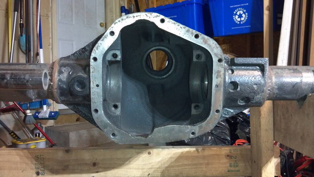

    Still a toss up on the ORIs for me. Just seems like adding sway bars would be a huge PITA and complicate things.
    Started shaving the 60. ~1.25" clearance
