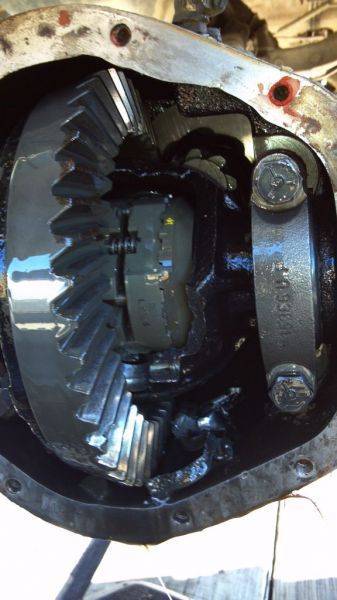

    And in other news, Supra TT blows up a locker today taking everything with it.

    Nice!! D44 lock right?

    Dana 44 FTMFW

    d44

    i also destroyed one of those in my toy 8.4 diff only there were more locker locker damage and less carier damage..
