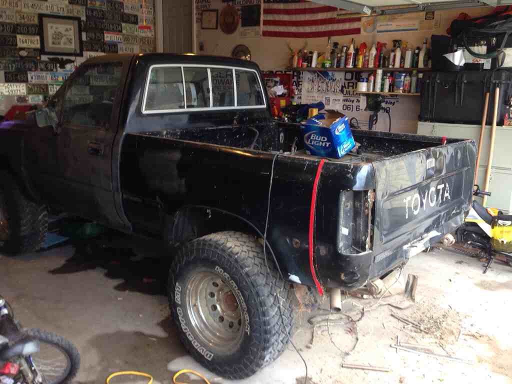

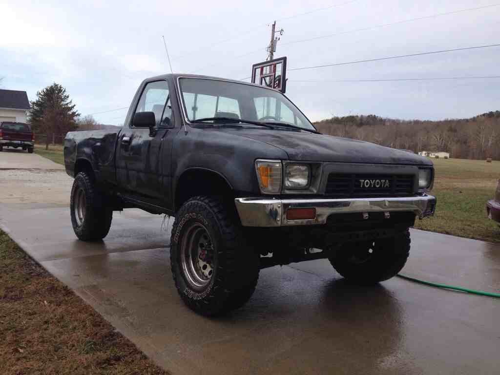

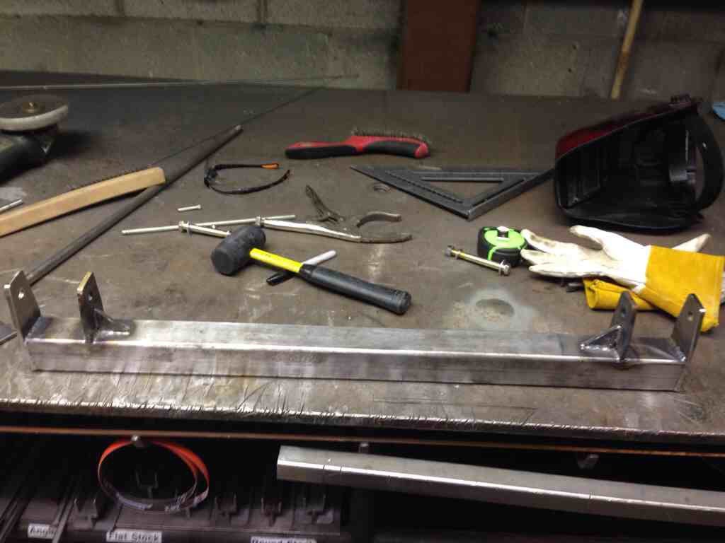

    Hey I am new to the SAS, but I am in the middle of a build. I got a 1989 Toyota, and have to rebuild the motor, and plan to sas it , I have got a stock Toyota axle. My plan is to use chevy springs on the rear, put the rear springs up front with a add a leaf, buy a high steer kit and shock hoops and shocks. I built a front hanger tonite(hope its right, built it off the Internet). I am trying to do it very cheap. So far how does my plan sound? Thanks for any input.
    Here the truck
    Started bobbing it this weekend, took out 12 inches
    The hanger I made tonite
    Thanks again, and if anybody got some good used cheap SAS parts let me know!

    personally I would advise buying front springs from allpro.. they guys that have done the rear to front thing well ive not been impressed buy the ones ive seen done personally I don't think they flex as well nore do they over come out right youll have to make adjustments.
