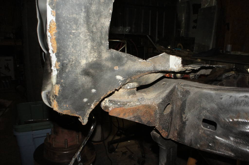

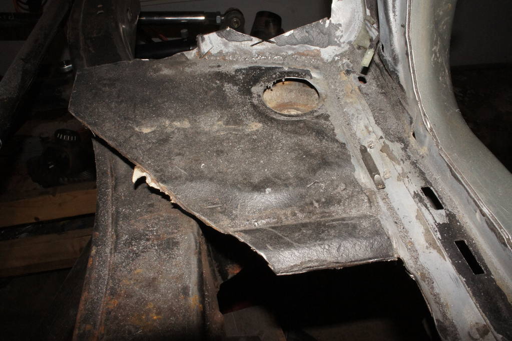

    What I shoulda done was start from scratch or just build a buggy. :D :anonymous:
    In regards to the cage, guess what? I'm thinking I'm gonna cut off more of the cab.:eek:
    The cab is currently welded to the body mount with pieces of scrap 1/4" plate and 2"od x 1/4" wall DOM. The body mount is in the most ideal location for the cage terminal end. Problem is-
    I can't do a doubler plate setup with the way it is now.
    So I'm thinking the best route will be to cut the body mount completely off and allow the cage run straight down the A pillar and to the frame.

    Frame would be the best.
