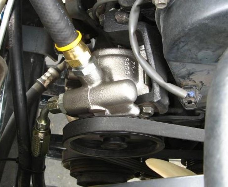

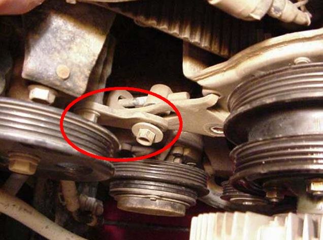

    Better spill the beans!! I figured this pump would work...
    http://www.polyperformance.com/shop/PSC-Extreme-Duty-PS-Pump-for-GM-Jeep-Suzuki-Toyota-p-1107.html
    Looking at the mount points on the stock pump and stock bracket, it looks like it will work. There is a small bracket on the bottom of the stock pump that should bolt up to the PSC pump. I know with the PSC 3.4 pump that they offered a while back requires a 1/4" spacer in conjunction to be able to bolt it up, not entirely sure about what needs to be done with the stock lower bracket. I've included a picture of the PSC 3.4 pump on a 4runner as well as a picture of the bracket Trail Gear sells and the stock bracket bolted in place. :confused::confused::confused:
  13. Feb 15, 2014 at 8:21 PM
    #3513
    thegame
    thegame Well-Known Member
    Mar 11, 2011
    #52855
    1,676
    Brian
    Folsom, CA
    Cement 2019 TRD OR
    You can see the spacer at the back of the stock mount in the first picture.
  14. Feb 15, 2014 at 8:26 PM
    #3514
    thegame
    Mar 11, 2011
    #52855
    1,676
    Brian
    Folsom, CA
    Cement 2019 TRD OR
    Oh and the PSC pump may be cheaper but you'll also have to buy a pulley for it which is another $40-50 so it is a wash, I believe. Unless you've got some other part number that includes a pulley.

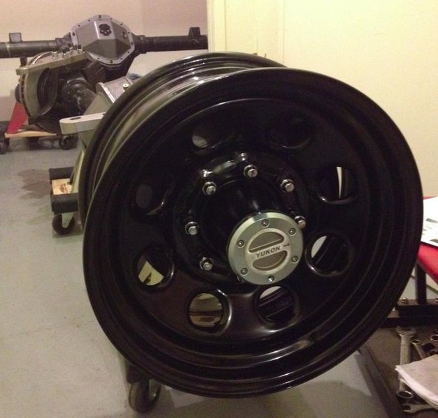

    Got my D60 completely assembled today :)
