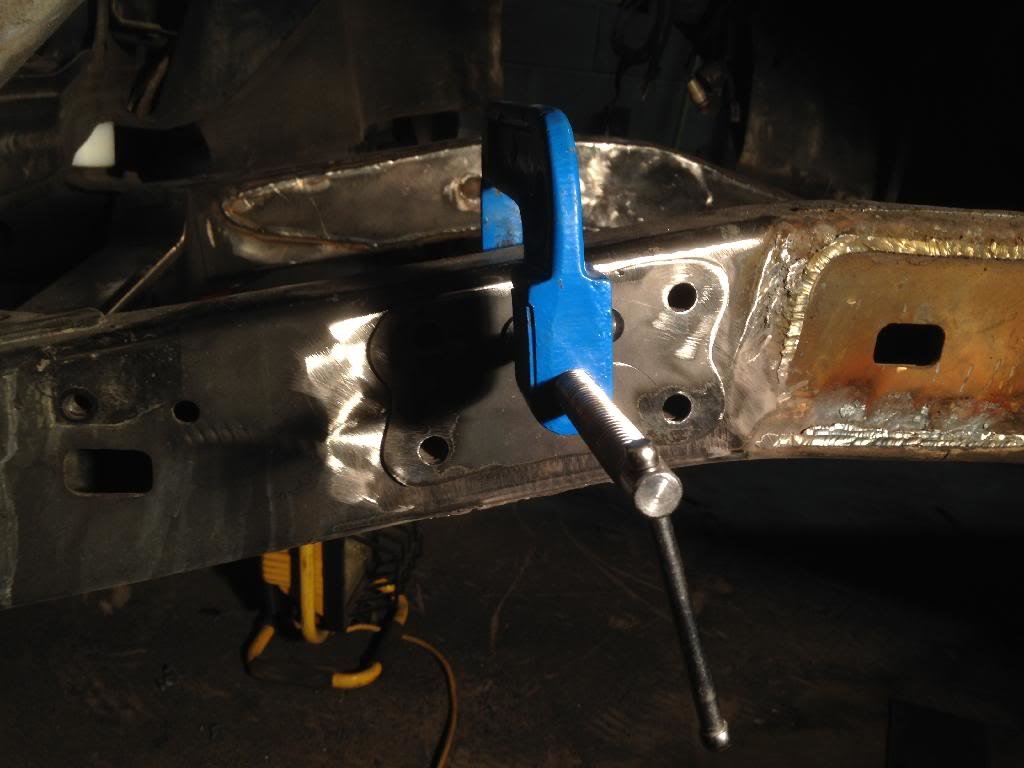

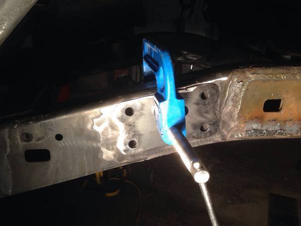

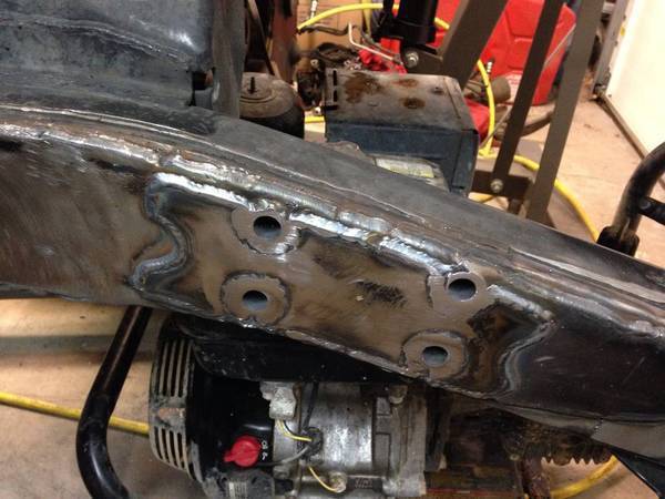

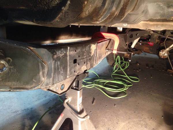

    B05B93CD-BDA3-4399-BF0A-E4DC47FE51D1_zps_2e2dd0a904386caaa8fbdc314cd04c90b2a189e6.jpg
    Its fully boxed front to rear think I need to plate anywhere beside where engine/steer box and spring hangers sit?

    Just plate everything.

    x2 ^^^ I plated front and rear on mine

    x2, usually you plate from the cab mount to mount for the core support.

    And even reinforce the motor mounts, ask NwiTACO haha

    It's plated with 3/16" from core support to first cab mount by firewall. :cool:
