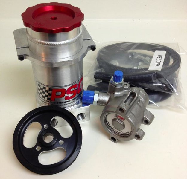

    Seems legit. They've redesigned the pulley a little bit. It now has 3 tapped holes around the center piece probably to easily remove the pulley if I need to rather than using a puller (still has the lip for a puller). Also has bigger machined cut outs so the mount bolt can be installed/removed without removing the pulley like you had to do a long time ago. I measured the ID of the pulley and OD of the pump shaft and get a .005" press fit between the two. As a machinist, this is a bit much, I would like to see .002" max. Can't blame anodizing as it adds less than .001" to the overall tolerances. Might call PSC on this issue :D

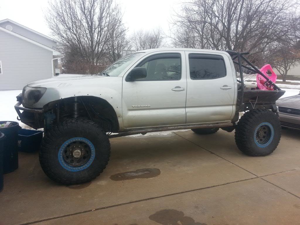

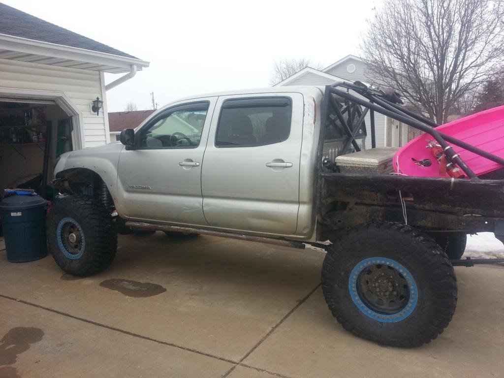

    21.5" Frame Height just behind the front body mount. 37" Tires. Don't let the gap at the front fender fool you, my fender wells are clearance big time. I could run 40's and not rub.
    Measure from the ground to the bottom of the frame if you're stock, and you will see the difference in height.
