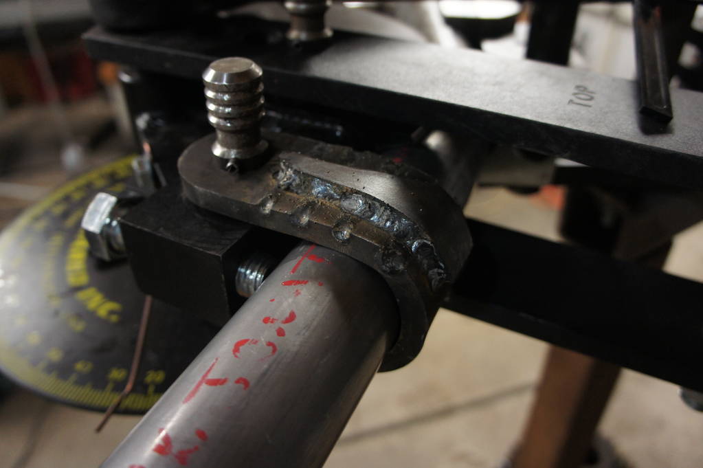

    Yeah I was originally going to get 10' sticks for the main hoops and after the boat sides + cutting out more of the body structure I measured again, and as best I could I guessed ~132" so I just asked for 140" just in case. There's BARELY any left over. :eek:
    I had a huge fuck up that killed most of my day.:mad:
    Things were going really well until the last of 7 bends on the first hoop. Setting up the tubing in the bender, I put the pin in the C shaped that holds the tube to the die only part way in. Forgot about it and started bending away, then noticed this-
    Tried a torch and sledge over a scrap piece of 2"OD .25" wall tube but it didn't budge. Finally used the whiskey bend and more scrap to reinforce it. So far, so good. :eek:

    One of my guys did that the first bend I had him do without me watching. What a pain to fix i used the 20 ton shop press to shape it back the best I could.

    Oh for the love of... why didn't I think of that?! :facepalm: I have a 20 ton press. :rolleyes:

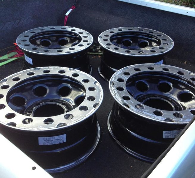

    :D Painting today...
