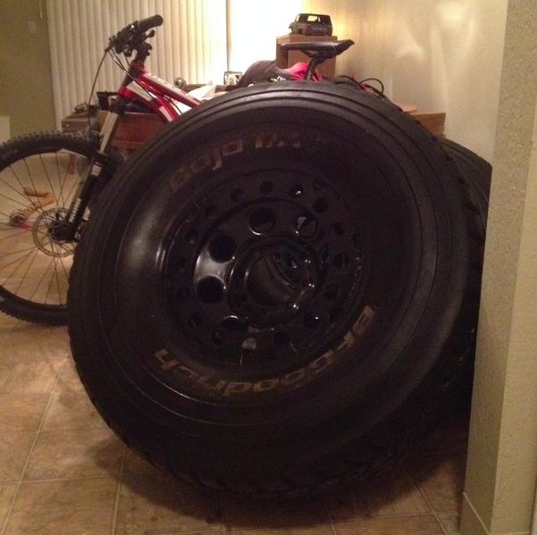

    Mounting these things was nothing short of a bitch. Still have 2 to mount and air up :rolleyes:
