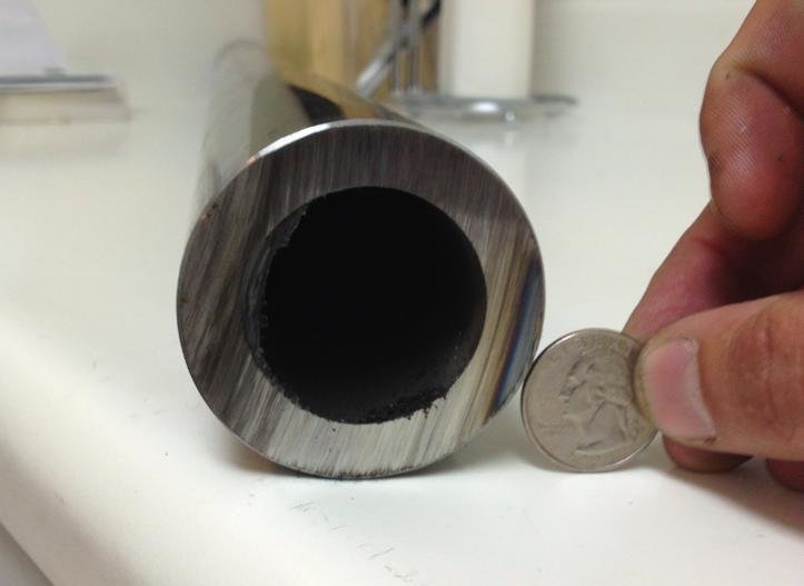

  20. Mar 7, 2014 at 10:41 PM
    #3800
    thegame
    thegame Well-Known Member
    Mar 11, 2011
    #52855
    1,657
    Brian
    Folsom, CA
    Cement 2019 TRD OR
    Insane beef :eek:
