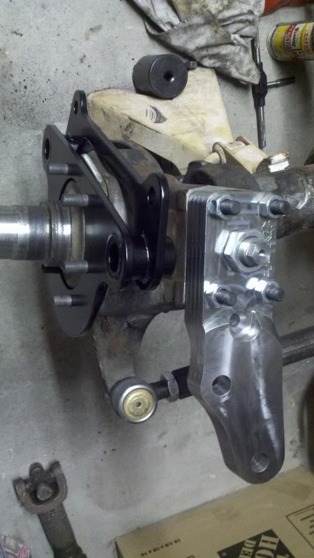

    Does this method of welding on plate to the stock steer arm account for Ackerman angle?

    I think these are the only Dana 60 steering arms that account for proper Ackerman, made by Northwest Fab. The rest of us don't care about a little extra tire scrub :p

    Really? Even on road?
    Why not run the 4wheelsupply arms then?
    I was going to go with WFOs arms because they're cheap(ish) and say they account for ackerman.
    But the 4wheelsupply arms are a good freaking deal if you don't give a damn about ackerman.

    One thing I have wondered everytime I see this picture...why isn't the tie-rod directly under the panhard when you're at bump? I can see that the panhard bolt is in front of the tie-rod.
    Based on how you have them set-up at the pass knuckle one-over-the-other, they should still be that way at bump.
  15. Mar 10, 2014 at 6:33 AM
    #3815
    45acp
    45acp Paint me back in Wyoming again...
    Aug 9, 2009
    #20861
    6,705
    Jonathan
    Boring, Wisconsin
    1981 Long bed 4x4
    Wut? Do you mean the drag link?
    I would think it wouldn't matter if the drag link was forward of drivers side knuckle since both knuckles are connected at the same point (pass. side drag link rod end).

    Derp. Early morning, lol. And yeah I mean draglink.
    I don't know if it matters or not, but I have never seen it where its not. Usually the box is positioned relative to the axle so that the draglink is 90° to the pitman arm when straight.
    Just never seen it that way is all.

    Any arm that mounts the tie rod outside where the king pins are, rather than inline with the king pins, will account for ackerman to some degree. The ideal ackerman is you can draw a straight line from the tie rod location, through the kingpin on both sides and the lines converge at the center of the rear axle. Obviously this is totally wheelbase dependent and short wheelbase rigs will need more angle built into the arms (potentially running into wheel/tire clearance issues) compared to longer wheel bases. If you're super concerned about having a perfect ackerman, measure your wheelbase and kingpin width and do some simple geometry to figure out where your tie rod needs to end up to achieve that and pick some off-the-shelf arms from there. Guarantee you won't find one perfect arm for your given wheelbase unless you buy hole-less arms and drill where you need to, aka 4 Wheel Supply arms. I would have gone that route but Chassis Unlimited is local to me and is a friend of mine :D Many many people drive on the street with Dana 60's and have a hard time believing any of them have perfect ackerman. We aren't building racecars :p

    Shoosh.... I prefer racetruck lol point well made.

    Another note on perfect ackerman, if it was a huge deal, truck manufacturers would make different tie rod mount locations for different wheelbase vehicles and they don't because its not cost effective to produce such a thing for little benefit.
