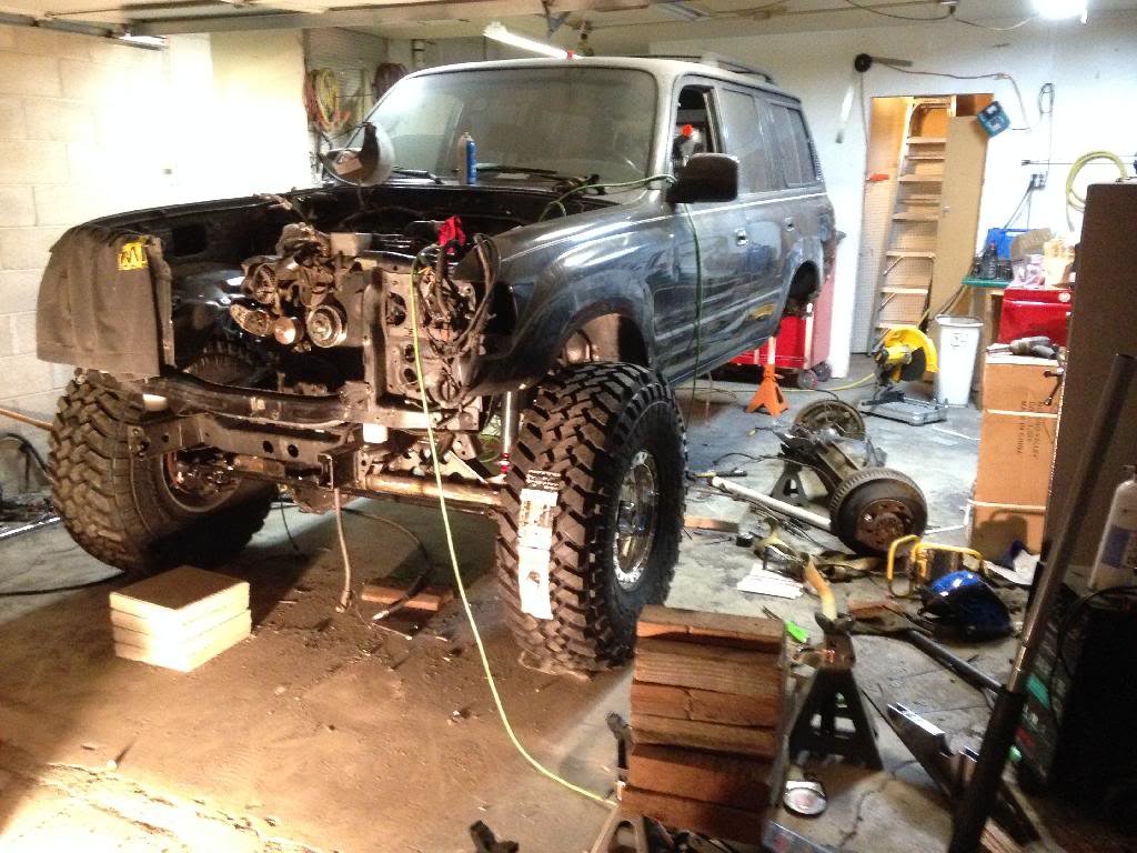

    Profender send good to go on all accounts.
    402FDD57-CF4F-408E-BC9D-D14D67CD6679_zps_2ce51862980bc55e6a80036a6224ae4973adca17.jpg
    22.5 at frame at full bump. Going for 5" up travel so 27.5" frame height with 40s

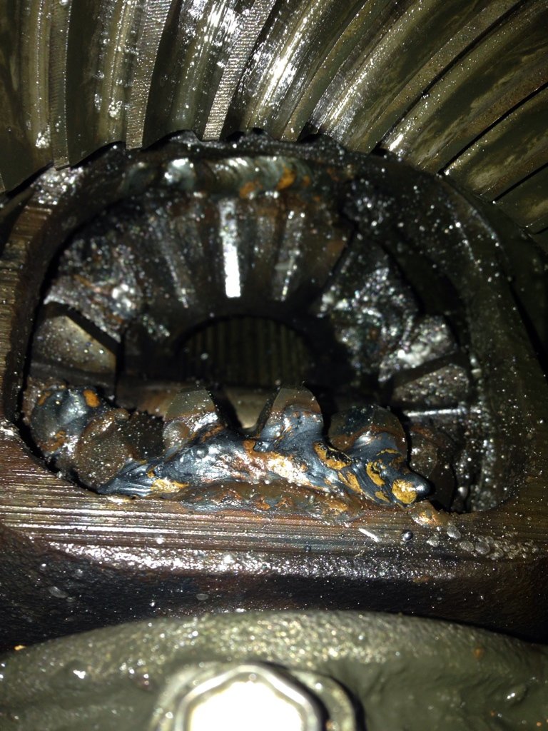

    Put my locker in the front today......

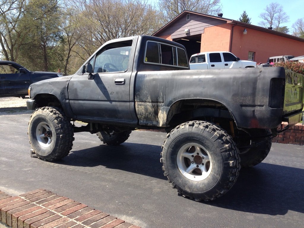

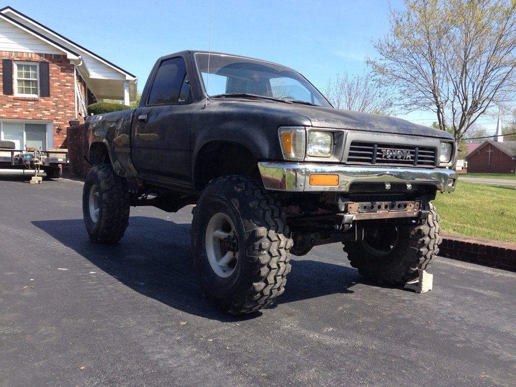

    Just a few little things. It's my DD
    Shes getting there

    Nice! Are those 35s?

    Yea they are old TSL. They suppose to be like a 35.5-10.50
