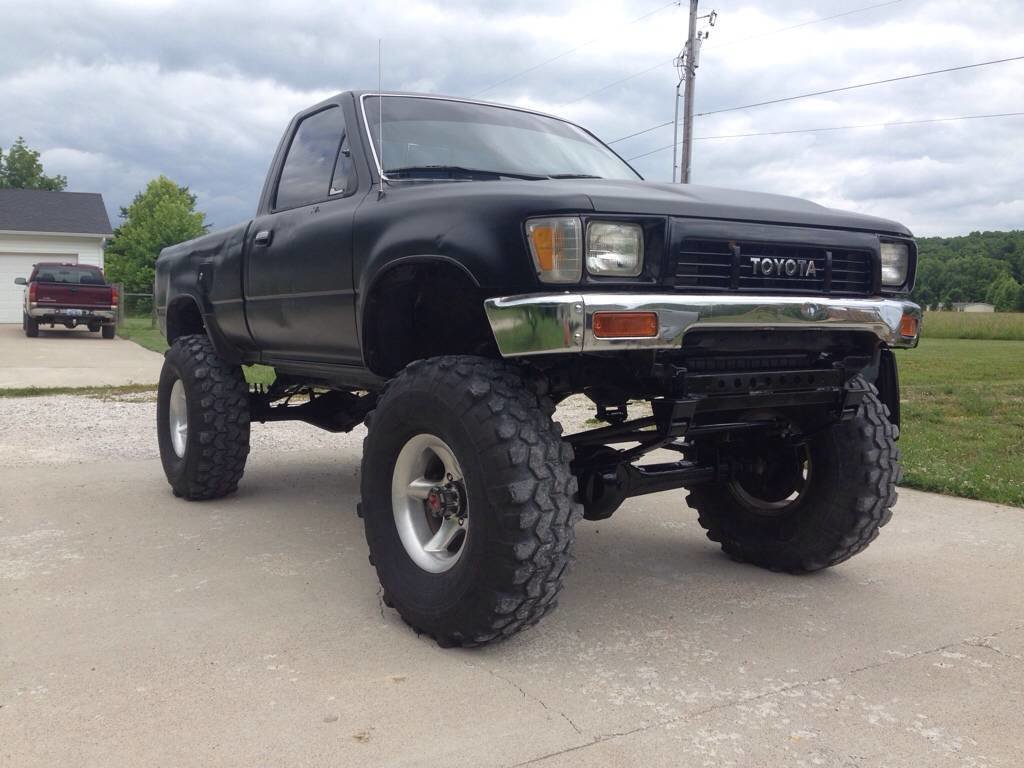

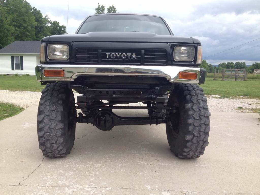

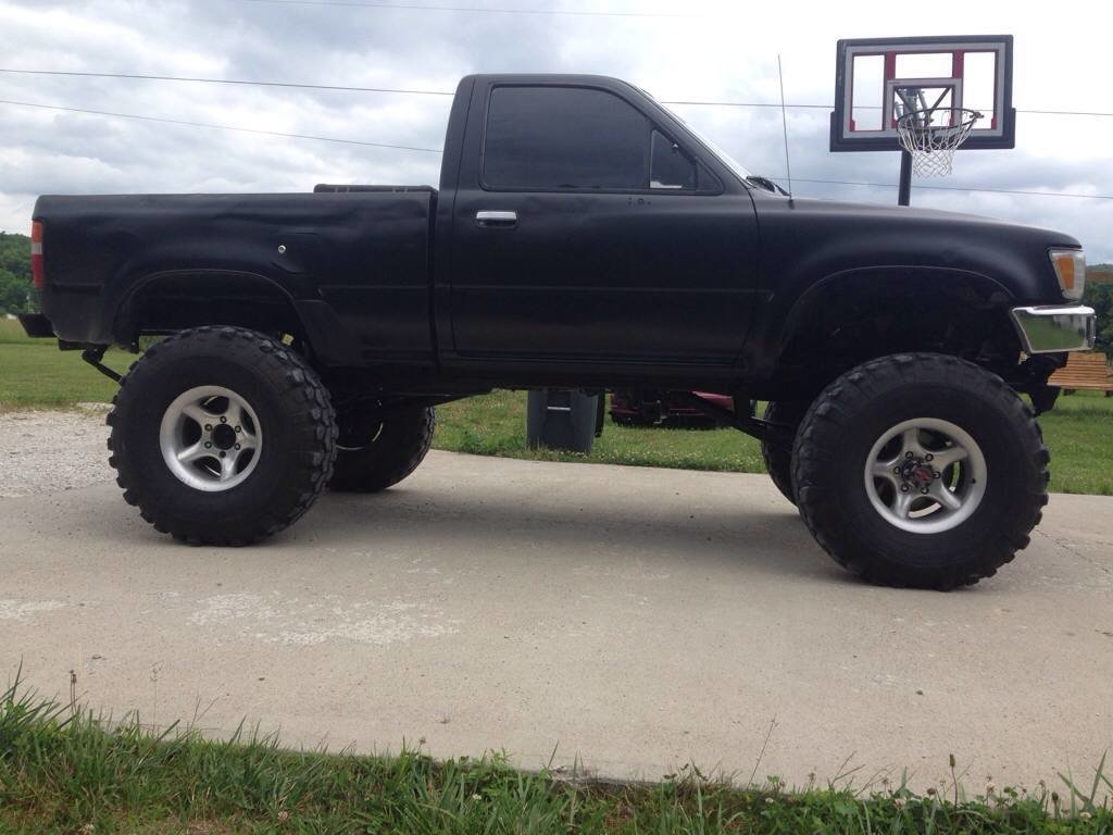

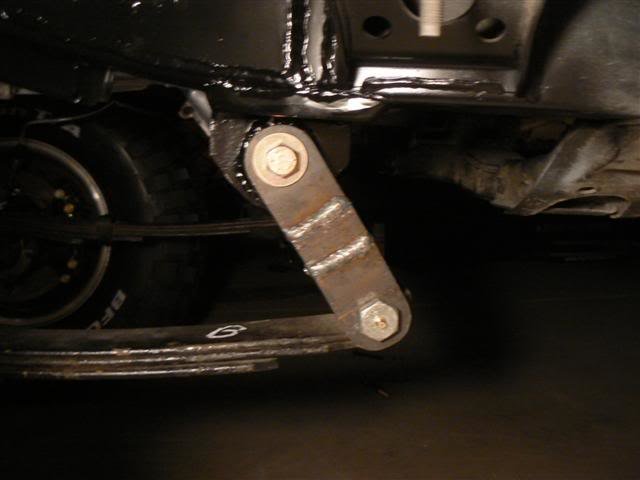

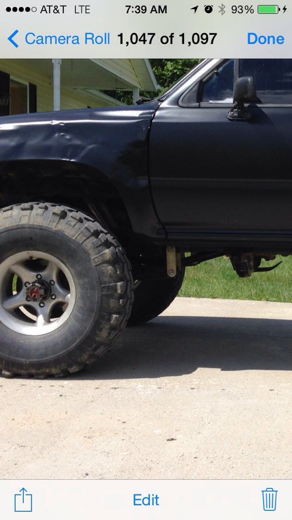

    Just a few little things. It's my DD
    Mines getting close,
    I'm up to about 3500$ total in this truck. I do have a question for you SAS vets. My front shackles have a weird angle. I'm wanting to know the cheapest, best, easiest way to fix. Or if they might be "ok" I'm not a crawler more of a give it hell on trails and mud.
    Thanks guys!!!

    Let the springs settle then see what angle you've got. May have to move the shackle hangars a bit forward, but I bet its ok once things settle.

    Thank you. The springs have only been on there about a week with very little driving. I was hoping the would settle a bit. I give it some time and see

    The shackle angle is horrible... been there done that. Cut it off and move it closer to the front. That's what they should look like AT FULL DROOP. Ride quality is poor and you will thank me later when you don't flop a shackle forward and break a leaf spring or worse yet, tear your frame :eek:
    Shackle angle at ride height - 40-45* angle.
