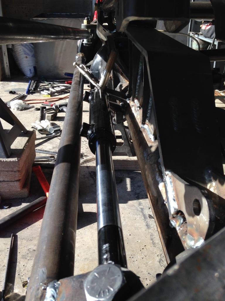

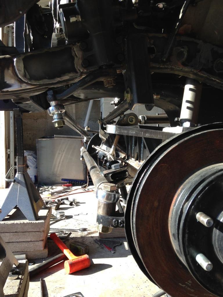

    Sweet, any better pictures of how the ram is mounted? Also, why mount the links so low on the axle?

    ill post up better pics of it later. I mounted the lower links lower to keep as much distance between upper and lower links. that way the axle has less leverage under heavy loads
    Keep in mind I have no clue what im doing nore do I own a tape measure just doing it all buy eye and using string so I get the lengths the same.

    Not trying to rain on your parade but, unless you are going for a 30"+ frame height on about a 37" tire you are going to be fighting that truss for any uptravel. Looks good though.

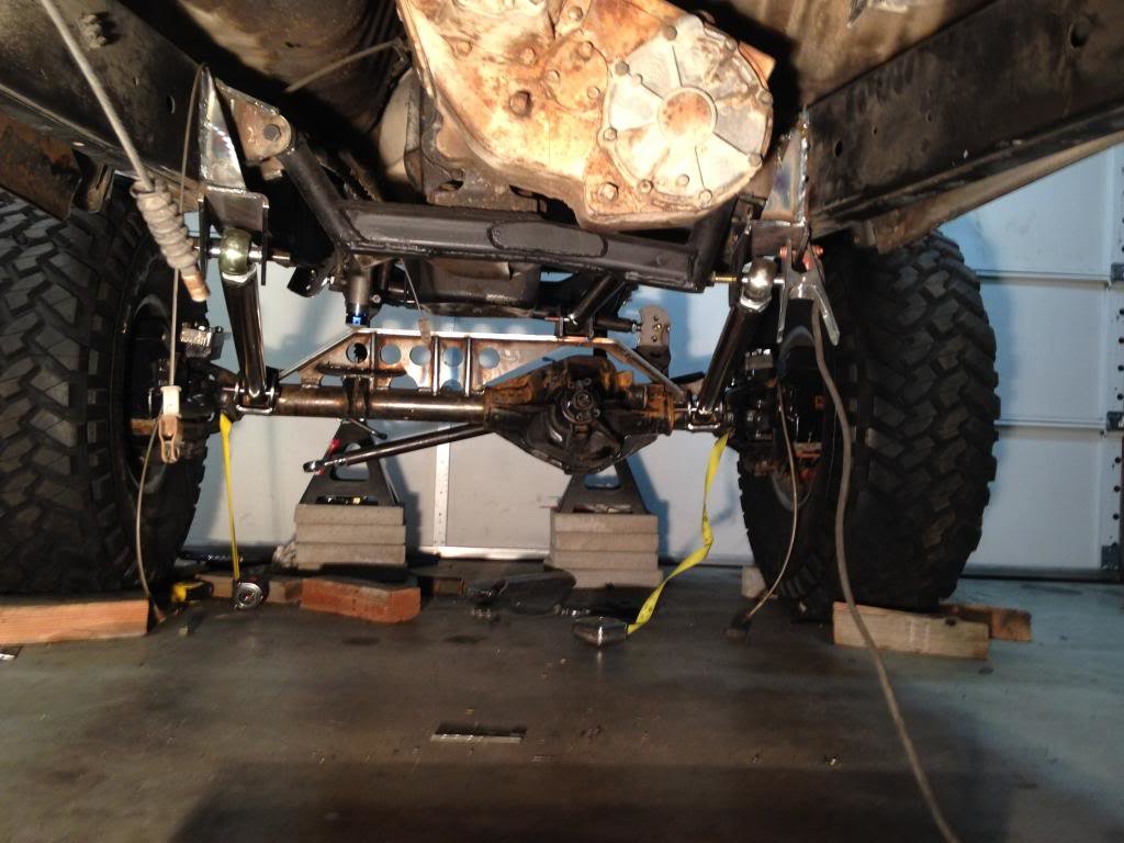

    oh you guys are gonna be so mad at me just did some looking into it with my string and looks like the frame height will be close to 34 inchs

    Well iirc it was sitting around 28 with 40s and about 4" of up travel.

    this is still guess work but this is 8" of up travel with 34" of frame hight. gonna try and drop it down. really didnt want to cut into my fenders for shock towers but thats the price i pay for running 18's

    34"!!! shit that's 10" higher then my rig :eek: Your should be able to get 16" of up with that frame height

    yeah if i cut the fuck out of everything which i dont want to do. remember i plan on running a 42-44" tire. also when i lower the truck that 8 inch's the oil pan sits on the hydro assist. yes it's the factory pan and i will end up changing it but that still doesnt mean i want to cut the fuck out of my engine bay to drop the truck to your 24" frame height. Keep in mind i snow wheel and bolder hop having a tall frame helps me in those elements

    I'm not saying drop it to 24" but you can get it a lot lower I think 28" would be a good height if you want tall on the 42's but that's just me. We do a lot of off camber rock crawling out here so high frame rigs tend to tip over on their lid.

    It does have a lot to do with what you're wheeling on and while i do some off camber stuff it's rare and i end up in places i need frame height more than anything.
    Dont get me wrong im not shooting for 34" of frame height i wanted 30" but the way it's looking unless i want to cut up stuff alot im going to end up close to 34" which doesnt bug me a ton just means ill have to be more carefull when i get to off camber stuff and or just use my winchs to take the height out of the truck. ill have front and rear mount winches so i can just suck the truck down and have a 90" droop suspention.
