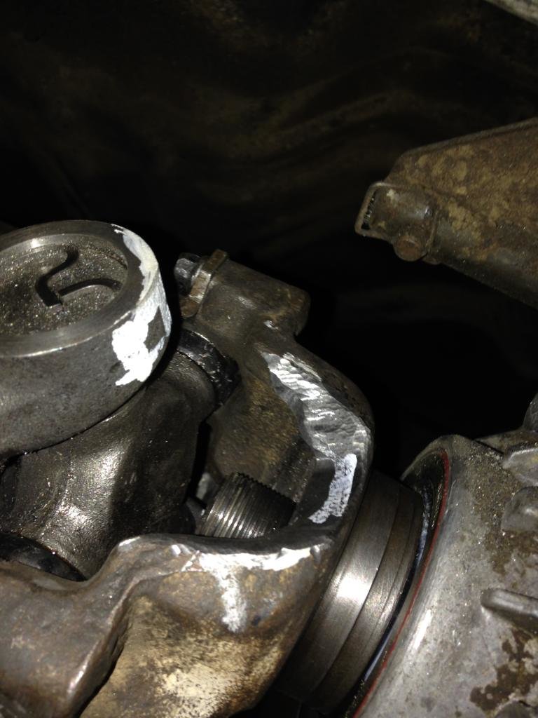

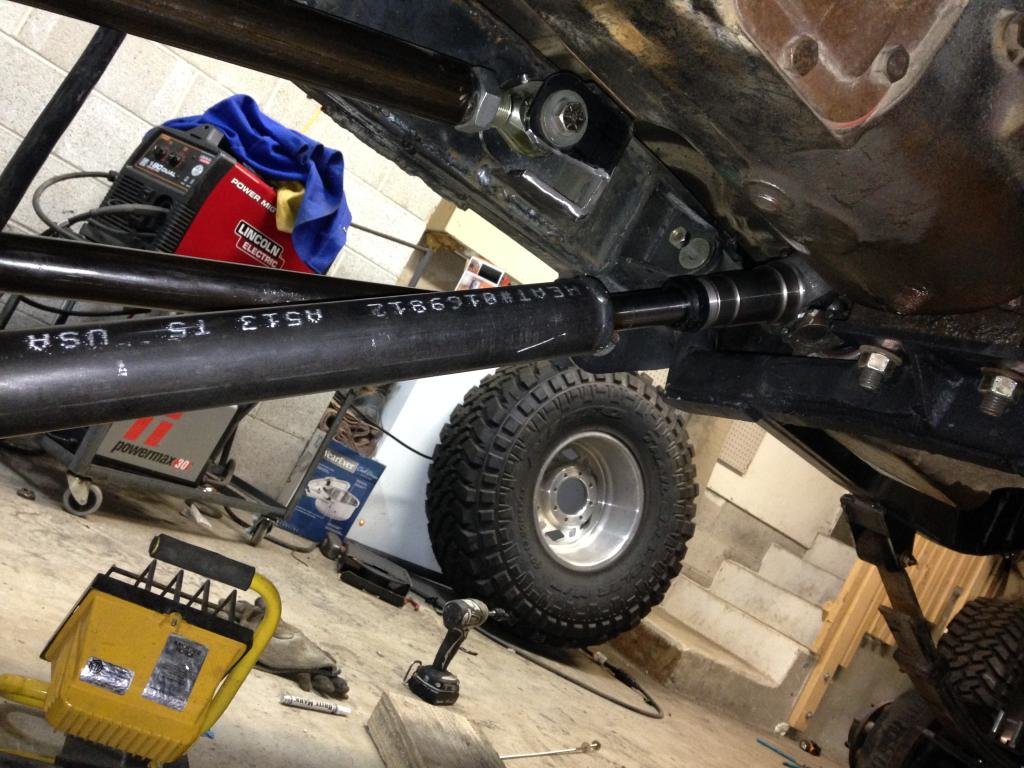

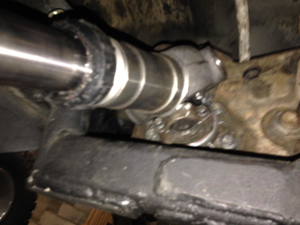

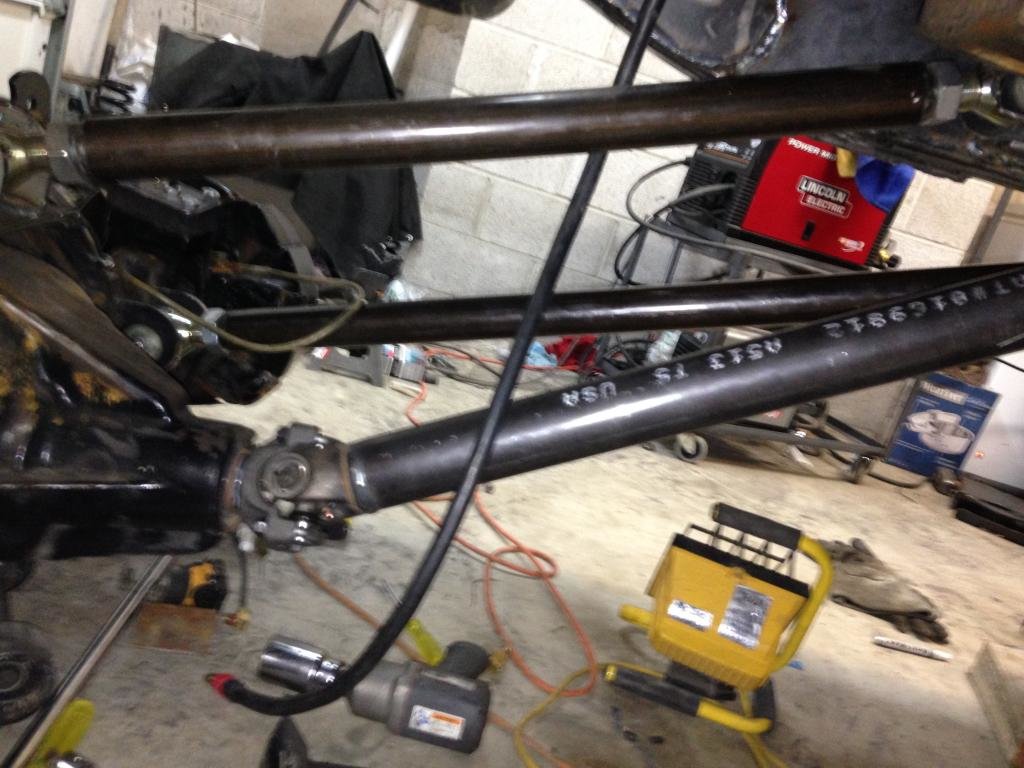

    Copied and Pasted if it seems awkward...
    So I got my drivelines from Dean, he's actually made it up this way and hand delivered them. Sweet!
    EVERYONE told me that single joint has more travel, I'm getting 32* out of the rear neapco 1350CV no problem. Have 1410 yoke on front output and 1350 yoke on D60. The 1350 end has plenty of clearance. Using one of those 1/4" extended yokes from WFO.
    1410 (supposedly more angle) binding like a dirty SOB.
    I've mutilated the yokes at this point, barely clears on the one side but going to have to demolish the driveshaft yoke to get the straps to clear it.
    I'm not really sure what to do. I'd bug Dean but he's off hunting. Keep partying on the yokes or what?
    Pinion is giving me no trouble, it's got plenty of clearance!
    Edit: I also fucked up and forgot to tell him I needed it solid stock for a bit after the t-case to clear my upper link mount so after dropping some significant coin on these shafts I had to mutilate my upper link mount at the frame. Will go back and box in.
    Shouldn't have cheaped out I guess. Thought single joint was better for more angle.
    Rear driveline game is on lock.
    Just slightly less angle than the front.
    I got carbide bur bits and compressed air out the ass but, not too keen on destroying shit and not sure how weak I'm going to make it if I continue...
    I don't mind limit strapping and I will run limit straps but not gonna limit 10" early.
    I also might add I'm basing this off the fact that profender says their 2.5s extend to 38" so the axle is sitting at 37"
    I've been waiting for my coilovers to return for months, and they were supposed to be here today but maybe tomorrow...
    So that'd be helpful but still 36 37 38 I'm binding like hell.
    Oh and I told him both shafts would be at around 32* full droop...
