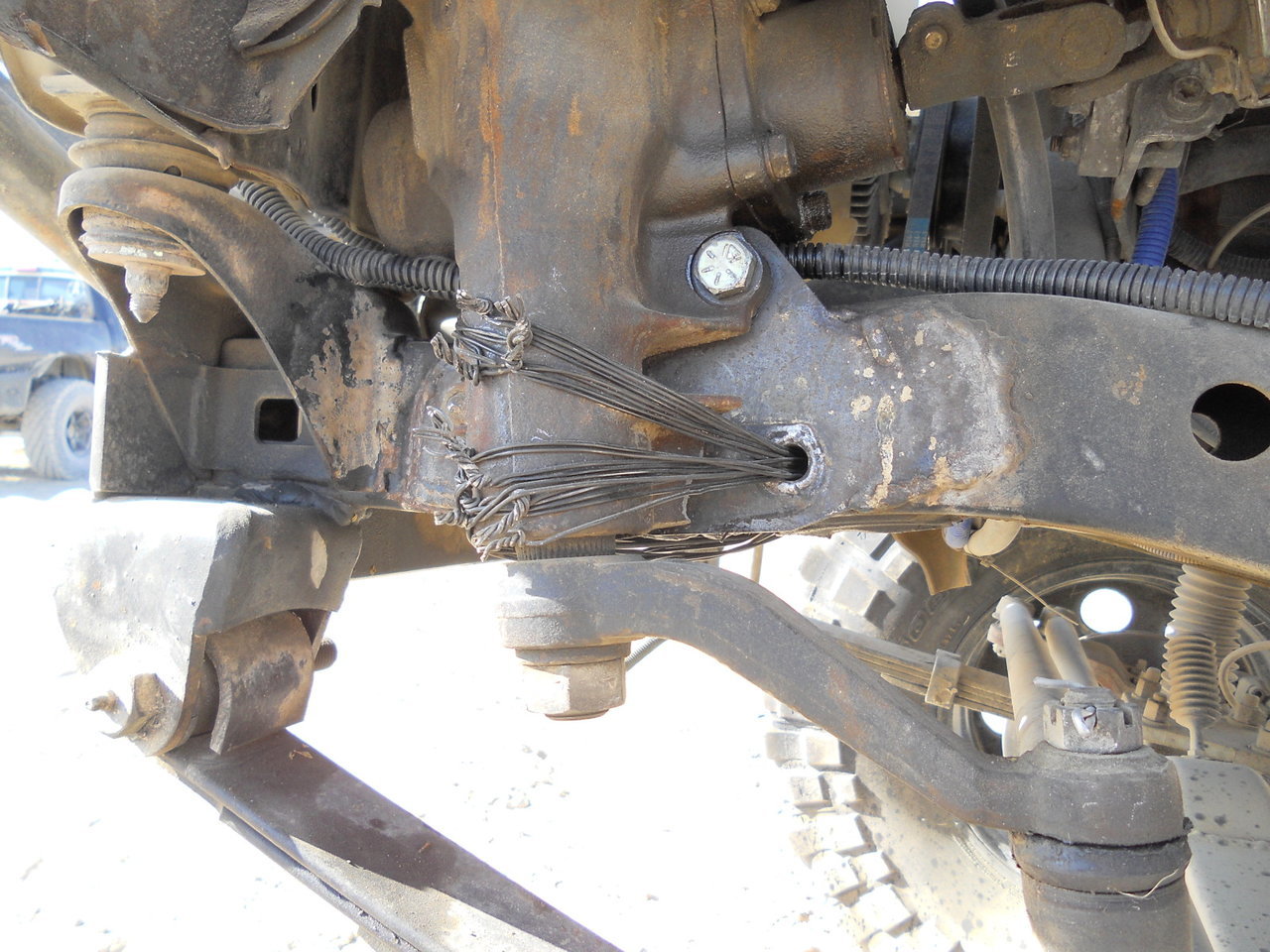

    Just curious by why are you going with a 14 bolt and not the dana 60 like everyone else does. i still have the 35 spline rear that came with my front 60 i went 14 bolt because i wanted it to be stronger and cheaper.
    hydro assist will help save your gear box from getting ripped of the frame with big tires. Just ask rocktoy about that one.
