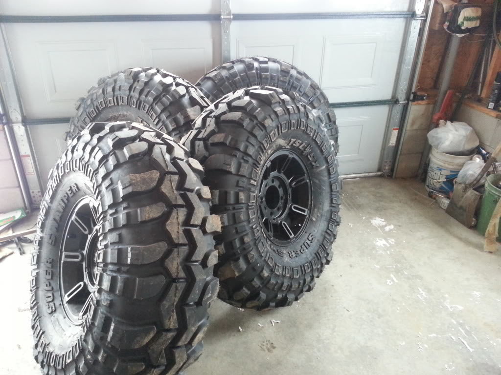

    Are you running Maxxis Bighorns?

    those are some used first gen MTR's stickies I picked up. probably going to buy irok's next when time comes for new tires.

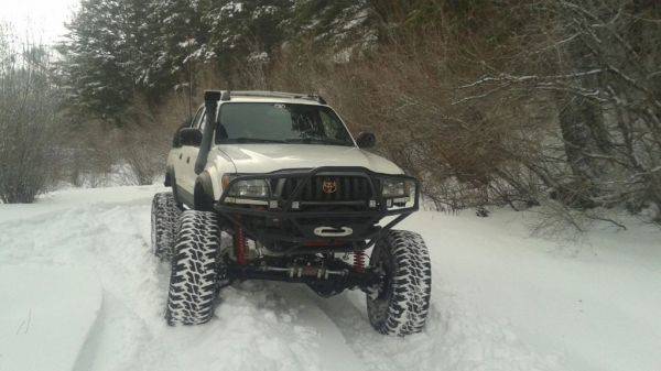

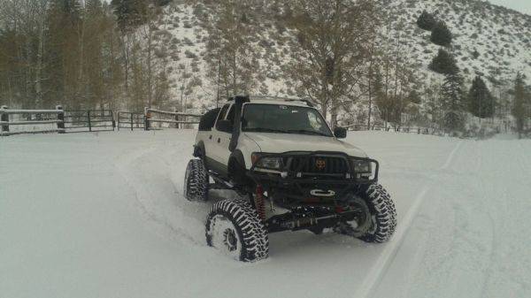

    This for street use you will want something that doesn't wander or turn your tires to quick. with my full hydro and a 6 turn valve I can still end up in the next lane or the ditch in less than 4 truck lengths if I so much as bump the wheel a 1/8th of an inch. there are things you can do to get it do drive better at high speeds like give tons of + caster and tow out the tires a few deg. Bad thing is those two things eat tires fast.

    Going to try and push to get a atlas bought Before moab this year and then im going to change a few things in the front end to get jut a hair more up travel. Ive excepted the fact that im just going to have to cut up my body some for 44's and that's just going to have to happen now :D.
