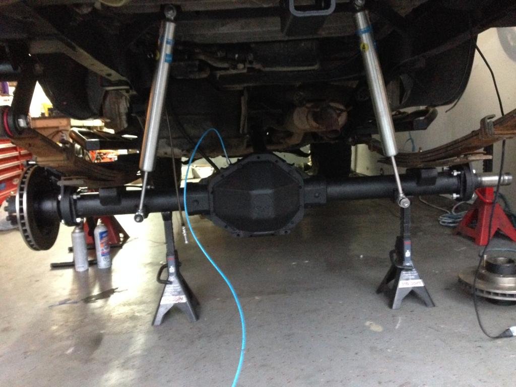

    built this last night. I was just going to buy one but I had a bunch op 3/8's plate lying around and this atlas dream before moab is going to be expensive so I need to cut corners in the mean time. also welded up my spare carrier so I can have a poor man locker for moab

    Nice, pretty sure I am welding my rear... I am poor haha
