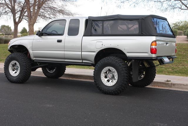

    Notice how my tie rod and drag link all sit above the springs.

    Ok, I get that, but why would you need that with links?
    Plus the fact of the 80 axles tie rod is behind the axle which saves it

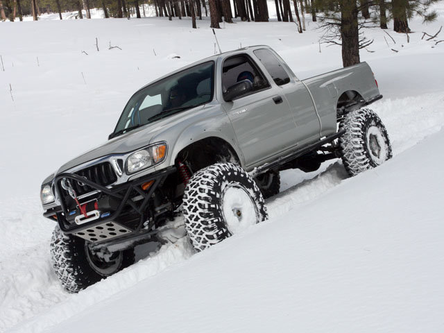

    looks like he tried to keep the atlas as hi as possible and that's all fine and well if you have 25" of frame height but im a bit taller so like I said the less body cutting the better.
    Edit I just looked at this guys build again and I noticed he didn't get the atlas4 he only has the two with some other crawl box in front of it and the truck started out a 2wd so some big differences I guess we will see. making another trip to the bank to day to shift funds around.
