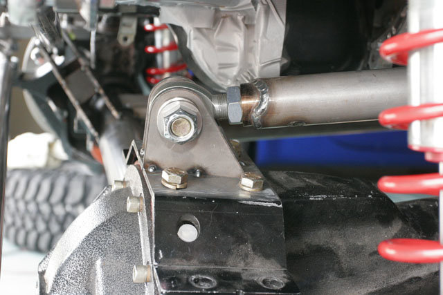

    So, since there isn't much room on the passenger side to weld a upper link mount... what you all think about this? It's not pretty, cuz its fucking MS PAINT so fuck off :luvya:
    Kinda like this, but obviously a little different since I have the hydro mount to weld too.
    Similar to this, but not bolt on of course...
    You get the idea though right?
