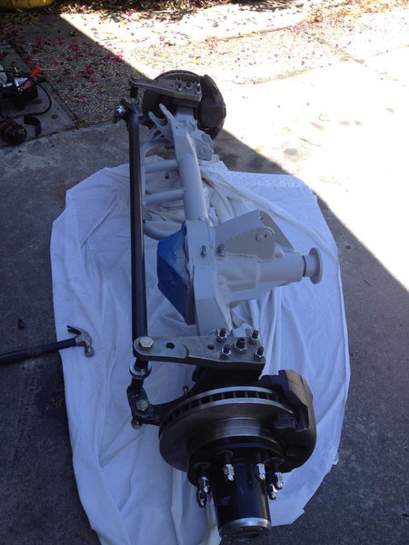

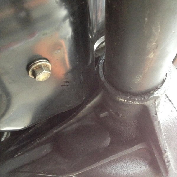

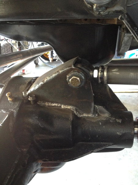

    I used my Lincoln 180 Pro Mig with Crown Alloys 44-30 wire and standard C25 gas and a MAPP gas torch to preheat/post heat.
    http://www.bakersgas.com/CRO-RS44_1F.html
    Do you have an axle yet? I know my 87 Ford D60 center section welded nicely. I laid so much wire in there, it's not going anywhere.
    When you shove a Dana 60 up there at full bump, you may find you won't have much room for a truss. My axle gets about 1/4-3/8" away from the oil pan at full stuff. I definitely wouldn't be able to have 6" of uptravel if I put a 79 Dana 60 in since the diff is more centered. The late 80's Dana 60 fits perfectly between the oil pan and frame. Super duty diffs are even more offset towards the frame so you might need to chop out some of that if you have a truss.
