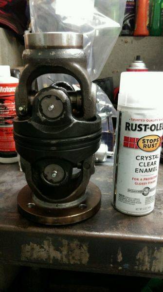

    CV for my front drive shaft showed up. it's next to a 12oz paint can

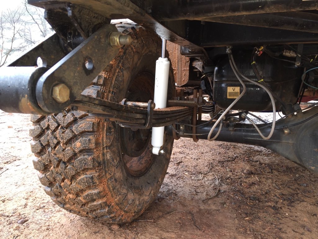

    So procomp six inch lift shocks aren't adequate for the Chevy 63's. :) already blew both rear shocks running mild trails. I'll primal just pull them for tomorrow. I have an extra set for the drive home. These are just temporary till my kings come in.

    Yeah the rear sucks. I need to redo the shackles and hangers

    Nice!! Looks pretty beefy lol

    Yup weights 45# and will do up to 35 mph at 42°

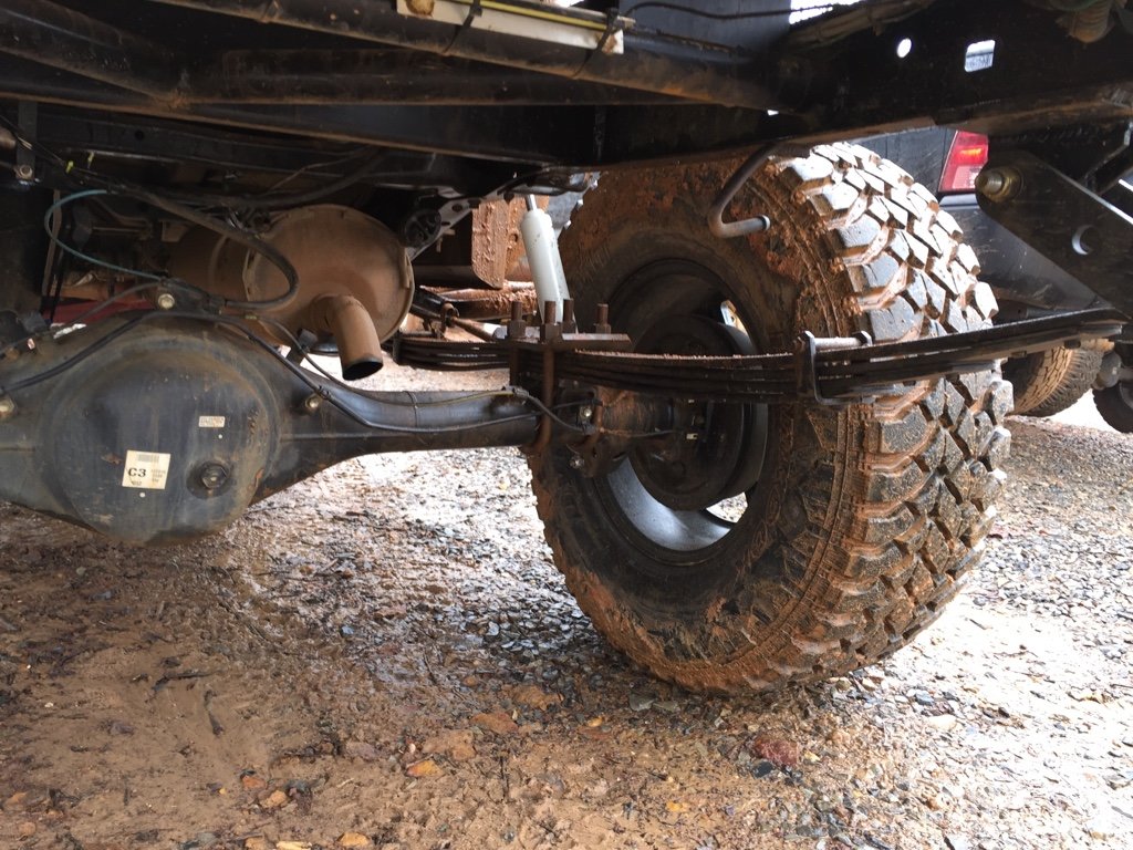

    Well this has turned out to be an expensive weekend. The driveshaft bit the dust, and I think I know why. The axle wrapped enough to bend the new leafs and allow the pinion to angle up too high causing the flange to break.
    Once the leafs have gotten to this point can they be re arched?

    You know what wouldn't have bent? Links!

    As cheap as 63's are, I would just pick up a new set. And fwiw that's why I left the overloads in on both my rigs. I will eventually remove them and put on a trac bar

    If these were just cheap factory 63's I wouldn't even think about re arching them. These are the skyjacker leafs. :(
    I'll either have the overload or the trac bar done before my next trip.

    Holy crap you did a number on those leafs. Those are definitely past the point of re-arching.
