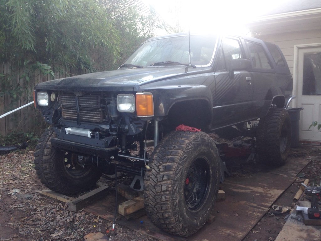

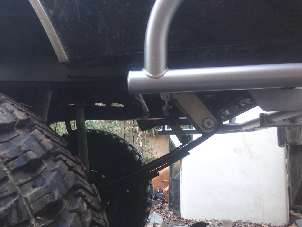

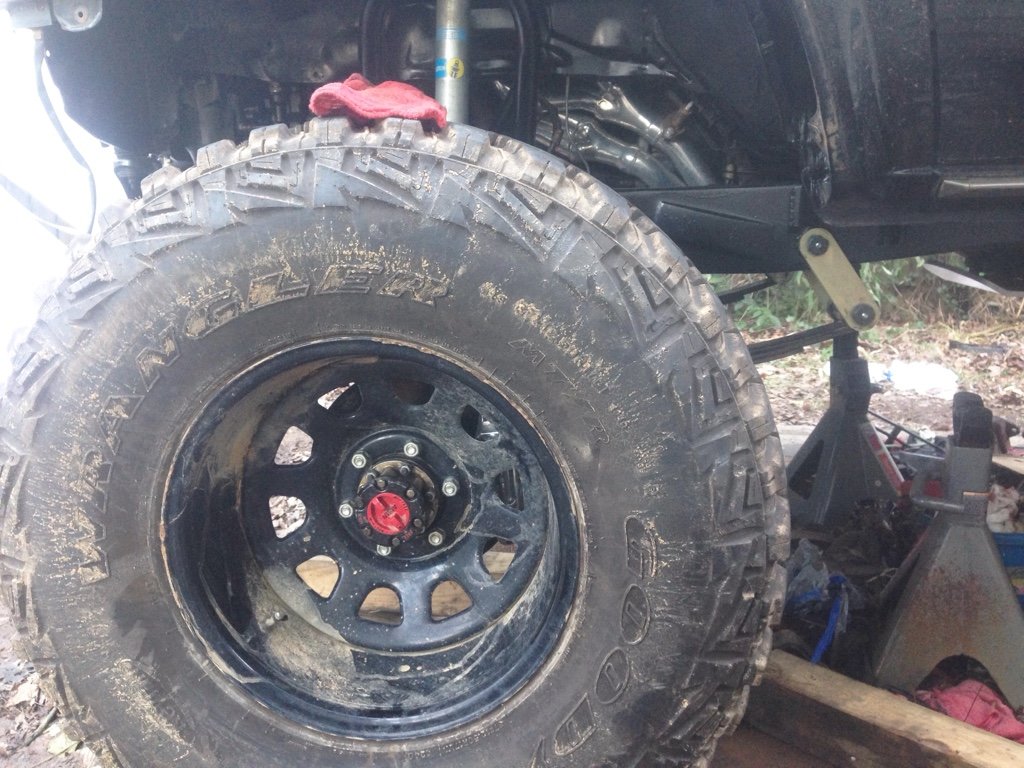

    #5119
    ajohnson
    ajohnson Glamour Shot
    Apr 19, 2009
    #16145
    8,496
    Andy
    Charlotte, NC
    07 DCLB TRD Sport Prerunner 4x4
    Things and stuff and such
    Finally got my 4Runner on the ground. How do you like the shackle angles?

  20. Mar 2, 2015 at 3:03 PM
    #5120
    Dragons Taco
    Dragons Taco Well-Known Member
    Jan 19, 2012
    #70993
    2,976
    Derek
    Cary/Raleigh NC
    06 Black TRD-S 4WD 4D 6SPD and MINE!
    Can ya spell Tonneau
    The bitch-mo-fo-runner looks ready to smash things. Leave some trail for us!
