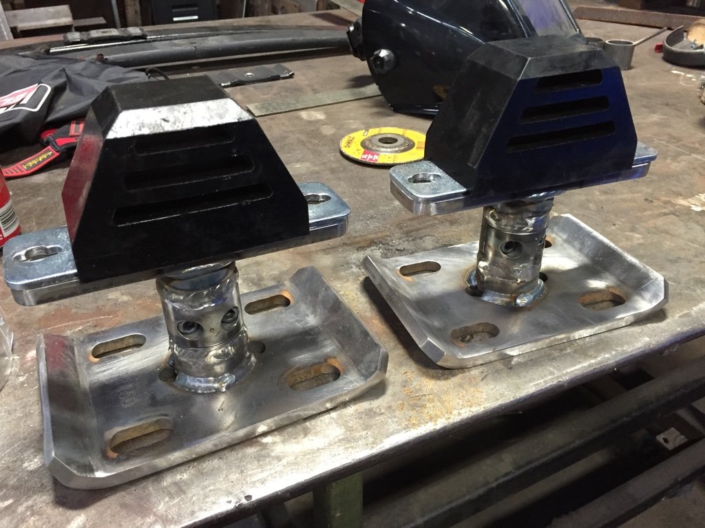

    One thing taken care of. No more wheeling without bump stops.

    That's an expensive bumpstop extension lol

    No shit, why not just use tube?

    The bump is too wide to get the impact onto the ubolts. The plan was to use tube only, but didn't work out.

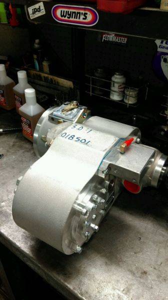

    it'll be another week before I get the truck in the shop and start on this. Guy forgot to ship the front output flang and im collecting speedo parts so I can wire it up to my Tacoma. 4x4 light and speedo will work with this bad boy. 8.16:1 total ratio.

    4 speed? I guess putting a 2 speed behind the stock trans makes the front driveshaft way shorter and actually binds because its so short.

    yes 4 speed. should make my drive line angle better, but im also going to lower the truck an inch and shorten my droop by 2 inchs so that should fix all the drive line issues I've had then again this is all in theory.

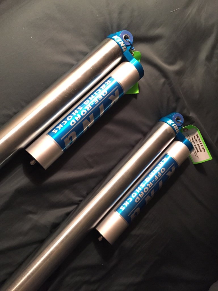

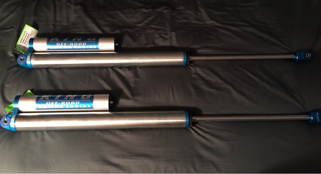

    2.0 14" travel. Rates are 150/100... We'll see how they are. I didn't pick them.

    Nice. $1000 is a good deal. If I could find that deal on a pair of 14 or 16" 2.5 Foxes I'd be in business :cool:
