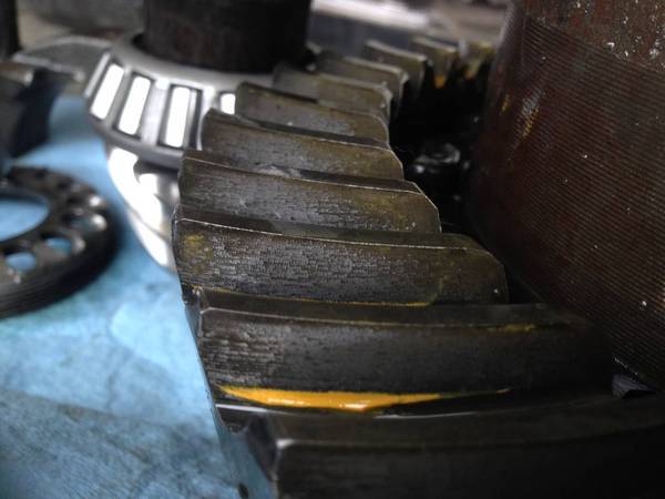

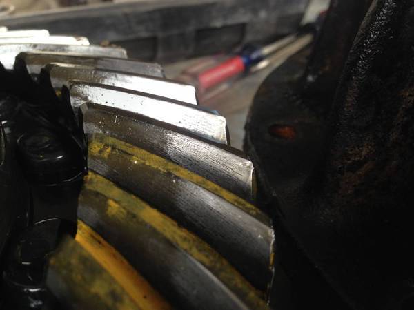

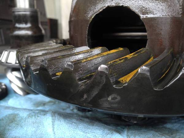

    Thanks to someone not knowing how to build a diff and doing it anyways, yes I already tore it up.
    They re-used the factory crush sleeve and just threw shims on top to make up the difference... The ring gear has some weird marks on it so I'm going to send some pics to ECGS and see what they say. If it's not salvageable I'm going to return the rcv's, sell what I have and build a 60/14.

    Oh it's a landcruiser third, I can build it myself no problem. Just trying to decide if the ring gear is ok or not. No broken teeth but has weird markings and the tips of the teeth rubbed on something

    The tips don't really matter as you aren't making contact with the outside edge anyway... unless you suck at gears. Those markings... I'm not sure about. But I say it's good. Might want to file some of them burrs down on the edges though.

    Yeah just heard back from ecgs. They said smooth out the tips and set it up correctly and it should be good to go
