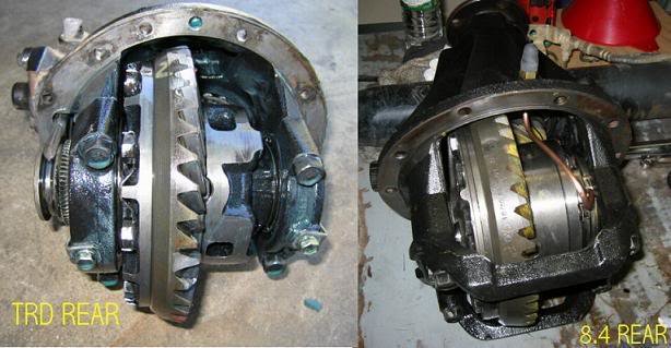

  20. Mar 20, 2015 at 10:21 AM
    #5300
    thegame
    thegame Well-Known Member
    Mar 11, 2011
    #52855
    1,669
    Brian
    Folsom, CA
    Cement 2019 TRD OR
    I like tossing this picture around. Note the massive girdles connecting the bearing caps on the non-TRD third member. And the "8.4" actually isn't 8.4. It has an 8" ring gear like the rest of em.
