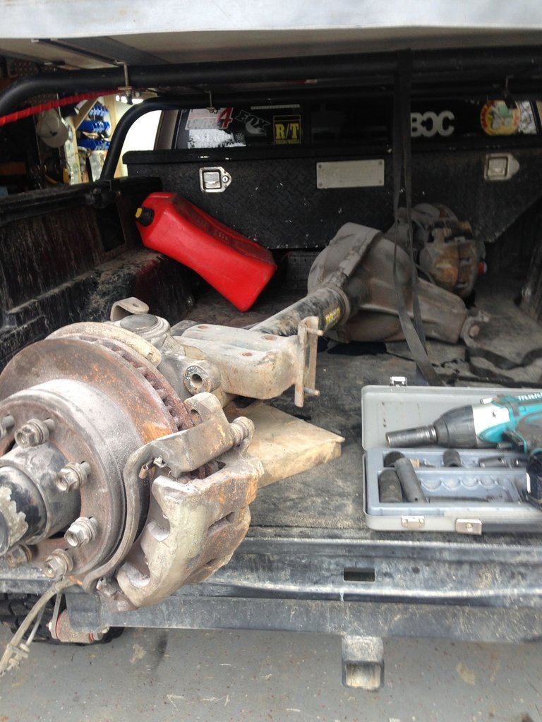

    5852827E-DEAC-4F2D-B434-93F7C75A34F1_zps_044ea7fa82b3e0a89bfc7d1a7644c3ea61f85325.jpg

    What year is it? Looks ball joint... 99-04?

    thought they had that style caliper from 92-04?

    It's 99-04 super duty axle.

    yup didn't even look at the hub.

    Yup it's a 03 balljoint, upside down only way could slide it in. Already apart waiting for shave kit to come in. Then TMR histeer arms, drill ub's to 6x5.5 and 35 spline, warn hubs, Yukon 5.13's and a arb.

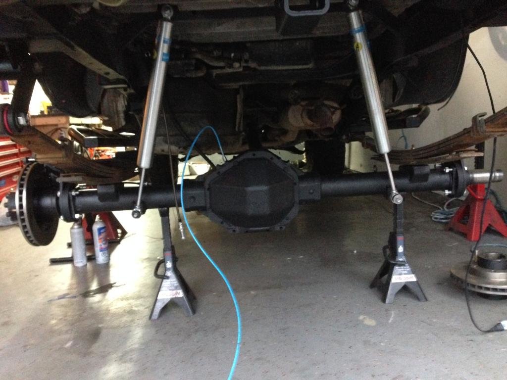

    Yup 14 bolt rear

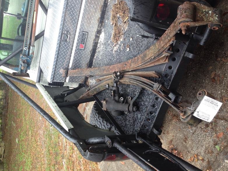

    Picked up some crucial parts for the build today from the local salvage yard

    Are those chevies? Which steering box did you go with... the one that has alot of turns or the one that doesn't?

    Yes on the chevy's.... They have an add-a-leaf stuck in there that will be pulled along with the overload leaf.
    IFS box out of a 94 4-Runner. If memory serves me correctly, this is the box that requires slightly less turns lock to lock.

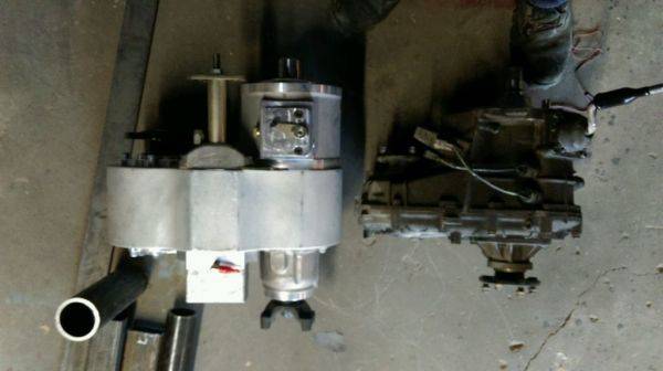

    so finally got to working on my taco last night. other than the Fuel filter looks like I wont be moving to much around. ill still have to cut the body up some for the shifter but that's about it.

    So what did the Atlas end up running you? My options are to buy an FJ case set up for twin stick and a crawl box, or buy an Atlas. Either way I'll be modifying/building mounts and driveshafts. The crawlbox and FJ case setup will run around $3300 in parts. Just trying to plan ahead here.
