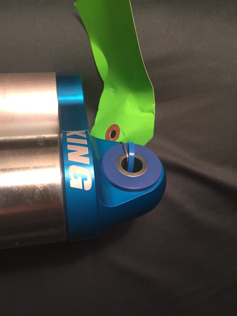

    I really need to get my rear kings installed, but I have a few questions before I start fabbing the mounts. One, do I need additional spacers top and bottom, or do I make my mounts fit the width of the upper and lower shock eyes as is?
    Second, these shocks are already charged, any advice on keeping them compressed for mockup? They're stiff as hell, which is what I ordered, but trying to hold them in a compressed state to check for clearance is a no go unless they're strapped somehow. I guess I can just tack in my mounts where I think they'll fit and mount them up and see what happens. Maybe a piece of PVC cut to size to hold in place for just a quick idea to see if I'm notching or not.

    You def need spacers up there. It'll just bind otherwise. Probably 1/2" each side and you'll be good.

    Ratchet strap them to their compressed length.

    Ok, that's what I was thinking. I've been looking for pictures, but that part of the process seems to be a known quantity so no one talks about it b
    That's a good idea. I'll have to see if my hooks will fit in the holes. Definitely have to wrap them up good so I don't bugger my pretty shocks.

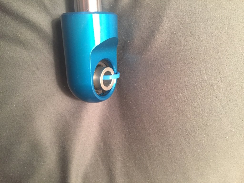

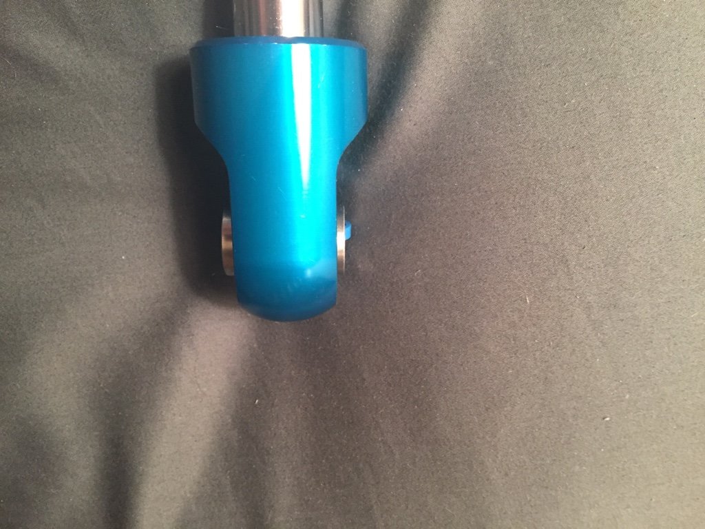

    Just looked at my shocks again. They're 1.25" width, top and bottom. The top won't rotate, so I don't see why I shouldn't just use a 1.25" width mount. The lower mount has the same width misalignment spacer, so theoretically it should be good to go. I'll lay things out as it is and go from there. I can fab a couple spacers and adjust the mounts if it comes down to it.

    At Schrader valve drop the pressure....will make it easier to compress and mock up....there's a k ternal piston that will desperate oil and nitrogen.
    The lower mount has a heim on lower yes space it out so it can rotate....the upper mount i would do a small spacer but more so make sure it its mounted so the bolt hole is front to back on urethane end for any possible bind....
    What valving did you go with and what's the applications...spring pack , front or rear etc....
    I went and bought a nitrogen bottle and started tuning my own kings again...used to tune all my own stuff revalve and rebuild....so started doing it again,....curious as to what stack they stuck in there...
