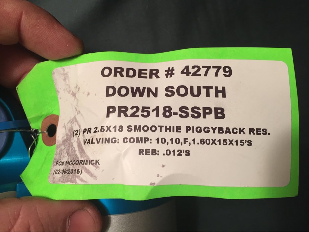

    Flutter is not always a 8.....it is usually a 1" and can be behind Initial compression shim or 2nd one back...usually it's the same as the stack if it's straight rate is all 15s... and can go from there....based on amount of slow speed bleed needed...smaller shim less flow or neck back on initial 2 shims in his case..
    My bypass are 8 compression and 12 rebound but I use bypass to tune and I'm inside frame rail with hydraulic bumps going in to assist bottom out.....
    All depends on the variables and use......weight, spring rate, ratio on shock mounting, use etc.....it's define try a art to be good....it's go on base and tune for my use....too much to try and do others without doing g it for a living....
    Thanks for posting up that stack....firm on slow speed bit bleeds enough to ease rollers and engages when slammed....

    That's why I said usually:rolleyes: but yes. My flutter is a 15.

    Awesome! Thanks for the lesson Brady. It looks like I have a bit of learning to do before I figure this stuff out.
    Good deal. You've confirmed that the stack is in line with what I asked for. :thumbsup:
    I'll be using 16" of that 18". I didn't want to go with a 16" and run the risk of bottoming out or over extending. Also didn't want to have to rely on straps. The cost difference was minimal.

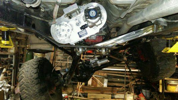

    making progress for the few hours a day I get to spend on her.
