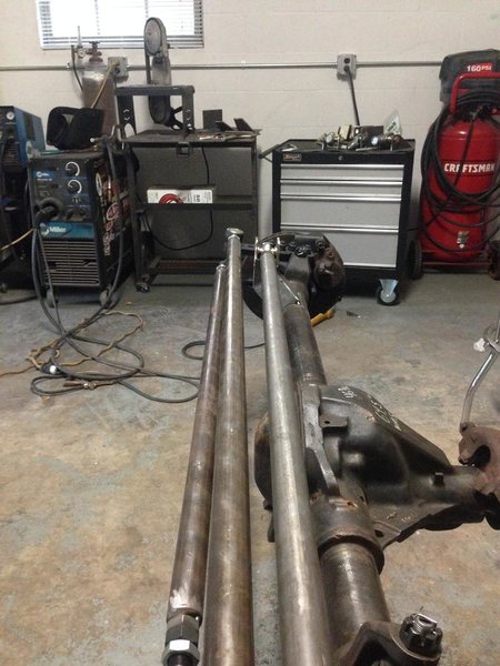

    7,226
    Eric
    Indiana
    2000 SAS D60 F/R Supercharged
    Supercharged on One Tons
    Holy shit look at these fucking axles!!
    F106 center with 2005+ SD SUPER 60 outers...
  20. Apr 14, 2015 at 5:33 PM
    #5500
    45acp
    45acp Paint me back in Wyoming again...
    Aug 9, 2009
    #20861
    6,706
    Jonathan
    Boring, Wisconsin
    1981 Long bed 4x4
    I don't even know how to respond to that.
