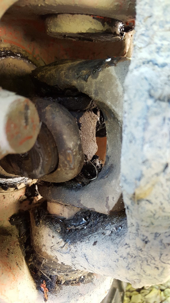

    #5740
    Supra TT
    Supra TT [OP] Supercharged Lifter
    Jan 3, 2011
    #48645
    7,226
    Eric
    Indiana
    2000 SAS D60 F/R Supercharged
    Supercharged on One Tons
    Difficult to see, but I broke a longfield u joint this weekend.... Need tons...
