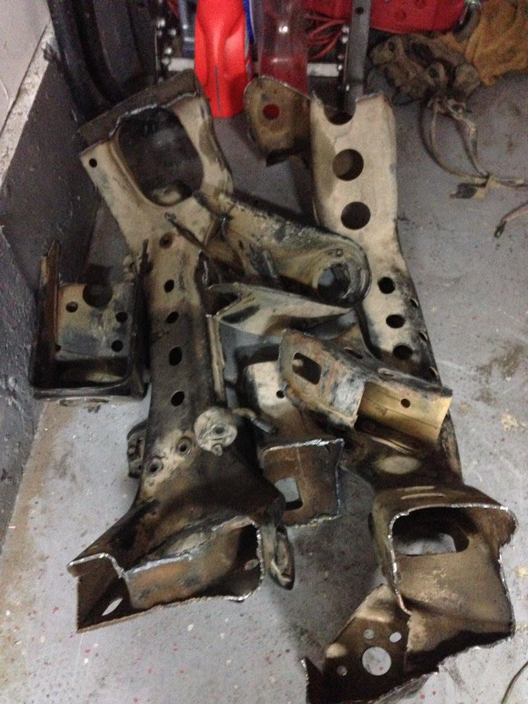

    Plasma is awesome,

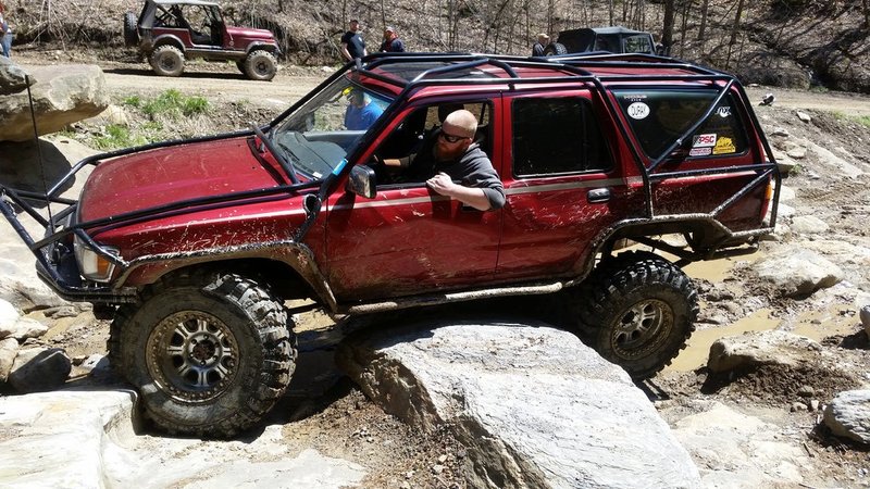

    All of which drive to any trailhead anywhere. The second gen mini was an 86 4Runner that was cut up and cab swapped. Has about $4.5k into the rig including the purchase price for both donor trucksimage.jpg 20150404_123957.jpg
