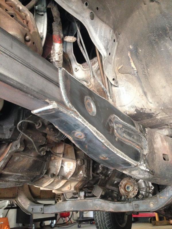

    In the quoted pic, the two fishplates you see here are 11 gauge. On the top and inside of the frame are 3/16" plates that were used box everything in.

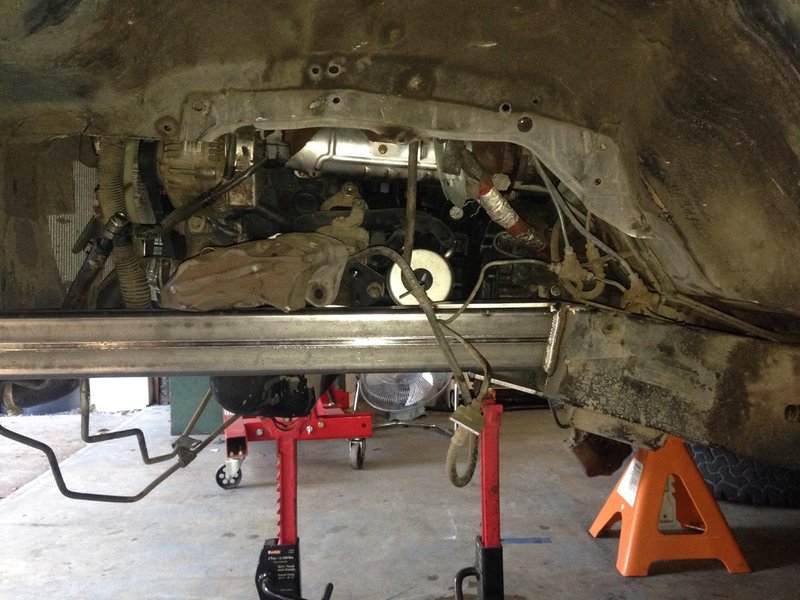

    Here are a couple more pics for reference.

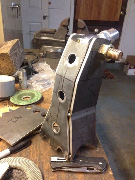

    Upper link axle mount complete
