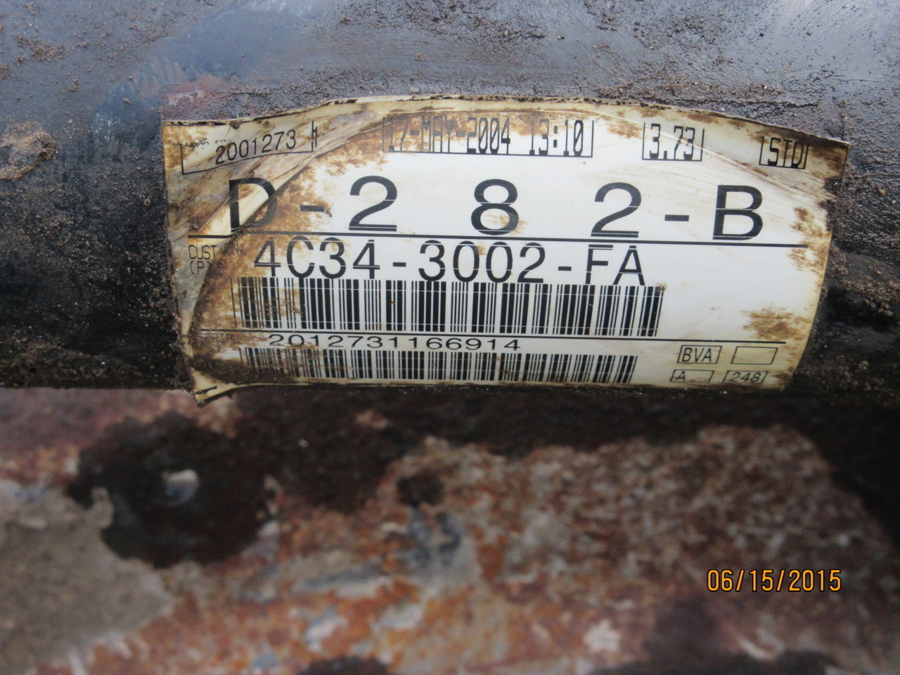

    The manufacture date on the axle was 2004. Not sure what year it is actually out of.
  8. Jun 15, 2015 at 6:00 PM
    #5868
    Supra TT
    Supra TT [OP] Supercharged Lifter
    Jan 3, 2011
    #48645
    7,226
    Eric
    Indiana
    2000 SAS D60 F/R Supercharged
    Supercharged on One Tons
    Got a photo of it? Most likely that date is the actual 04. 99-04 all the same, pretty good axles.

    This is what was on the axle.

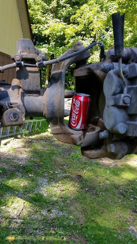

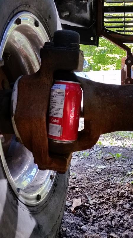

    Just look at these SD axles

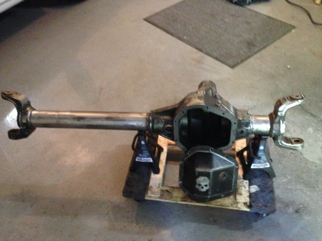

    Just choped driveside leaf pearch and welded tubes

    It says 248 on the sticker which is the code for Dana 60 if my research is right.

    Tag shows Bom #248 which is a D60, 229 is code for d50
