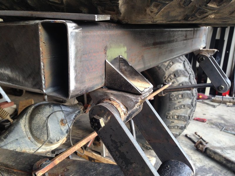

    I fixed that yesterday,
    f6690de47c992872ccc635c0aa00882a_zpsv42c_99a55bae40ab7a15ead838c13166ed9d9490e8cd.jpg
    f2792efdbe13eb2a74eebdd03aeb37e8_zps2hxw_180a9a6c378a2696741bf13eae0ca0b1e4b3b8ee.jpg
    f1d7bbbc391f7f3f2376110f9f88af58_zpsrxdr_c2b747cefd973bcfc285c0f2d23c6fd2964c7c5e.jpg
    Made a corner truss out of 1/4" plate, that tube ain't going anywhere now.

    I'm wondering if that reinforcement you put in will clear the frame at full bump and articulation.

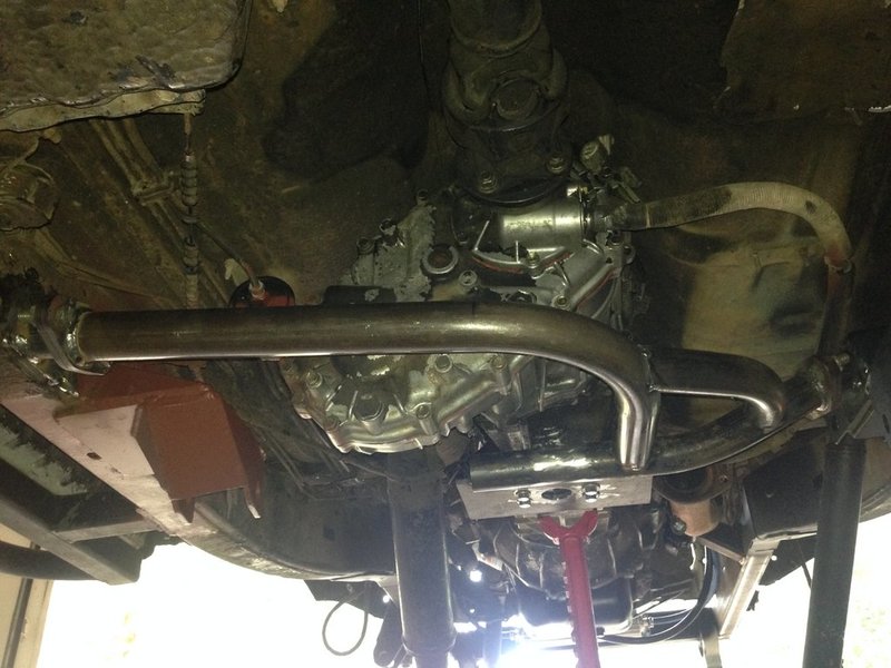

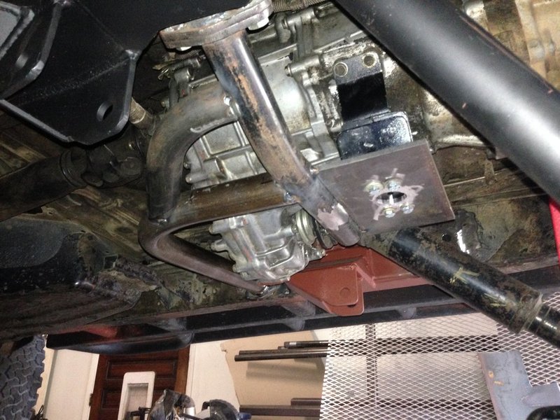

    transmission crossmembers are a real bitch to build when there is a ton of links/exhaust/driveshaft in the way.

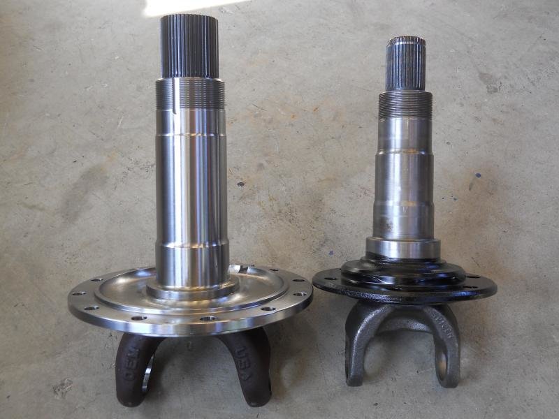

    47 spline 2" shafts vs measly 35 spline LOL..................
    1414313d1407544505-ouverson-engineering-_11b6f7ff39bfcedb9d0693c1ce6be13caa2209ea.jpg

    I mocked it up under the truck, it should fit fine. Reason I went with this over a full top truss like tmr's which would take up lot more space

    and what axle does that 47 spline fit?? looking at the size of that spindle it's gotta be a Rockwell or some shit.

    Is that rockwell ouverson shaft?

    It fits Dana 60. Gotta convert to Rockwell outers though. It's what the good rock bouncers are using. Ouverson knuckles and outers with 14 bolt centers or some go with a 10" center on a custom housing. But, the good ones all use the Ouverson parts!! MMM sexy

    If I haven't broke my 30 spline stuff doing 4 wheel burnouts on 42's then I just don't see the need for that in our application.

    I wasn't suggesting anyone switch to it.... 4 wheel burnouts doesn't mean shit, there's no traction there, nothing to break. A dana 30 can do a 4 wheel burnout. Breakage occurs at anytime, but mostly from when you've got spin and then ya don't. I was simply posting a bad ass photo of some bad ass SAS shit, basically why I created this thread.

    Anyone have any objections to me doing it this way?

    Nope, seen them done like that many times

    If it were me, I would take the gusset/stiffener all the way to the top of the rectangular tube. You're also going to be relying solely on the weld between the rec. tube and the frame to support the rear of the leafs. You might want to consider wrapping some plate around the rec. tube back to the frame rail.
    I'm a fan of overkill though. :D

    Would be better if you had a way to make them one piece. But if not, that looks like it would work just fine.
